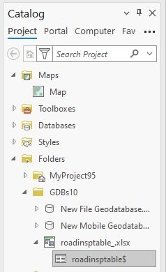

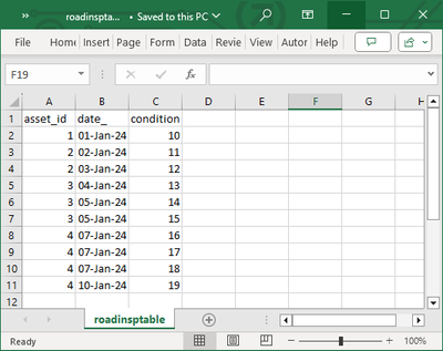

I have an Excel .XLSX spreadsheet that I want to use in ArcGIS Pro:
When I navigate to the spreadsheet in Catalog, I see that Pro has suffixed the sheet name with a $ (dollar sign).

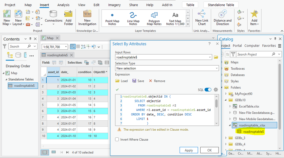

That dollar sign at the end of the sheet name is slightly awkward when using the name multiple times in scripts, such as a lengthy SQLite SQL expression.
ArcGIS Pro uses the SQLite SQL dialect for expressions on Excel files?
roadinsptable$.objectid IN (
       SELECT objectid
         FROM roadinsptable$ r2
        WHERE r2.asset_id = roadinsptable$.asset_id
     ORDER BY date_ DESC, condition DESC
        LIMIT 1
It’s a small thing, but I find the dollar sign adds a bit of clutter to the code.
