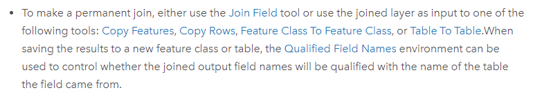

The Add Join and then exporting to feature class or shapefile is working fine with me. The resulting table has all the attribute fields of the joined table.
Perhaps try running the Join Field GP tool, which will add the new attribute fields to the existing Feature Class (you do not need to exp[prt to make a copy of it - if this is what you require).

I agree with Mervyn - this is expected to work as described in https://pro.arcgis.com/en/pro-app/latest/tool-reference/data-management/add-join.htm

Thank you very much. I had the same issue, but when I tried table to table it works. I also had some fields giving errors. But I used table to table, everything is fone. I reapply appreciated it.
