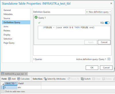

Bud
For what it's worth, your original syntax seems to work fine on Oracle tables in ArcGIS Pro, both on versioned and unversioned tables:
FIELD1 = (case WHEN 1=1 THEN FIELD1 end)
The brackets were just for legibility. They're not a subquery. It works without the brackets too:
FIELD1 = case WHEN 1=1 THEN FIELD1 end
Oracle 18c; 10.7.1 EGDB; ArcGIS Pro 2.6.8
