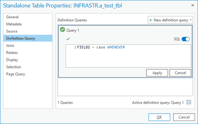

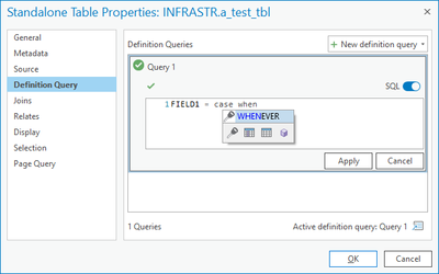

In the Definition Query window in SQL mode:
When typing the word “when “, it autocompletes to “WHENEVER”.
I don't know what use case WHENEVER applies to, but 99.999% of the time we'd want WHEN, not WHENEVER.
Example:
I typed  "field1 = case when ". Note the space at the end of  "when ".
It autocompleted  "when "  to  "WHENEVER".
That's not what I wanted. It changed valid SQL to invalid SQL.
