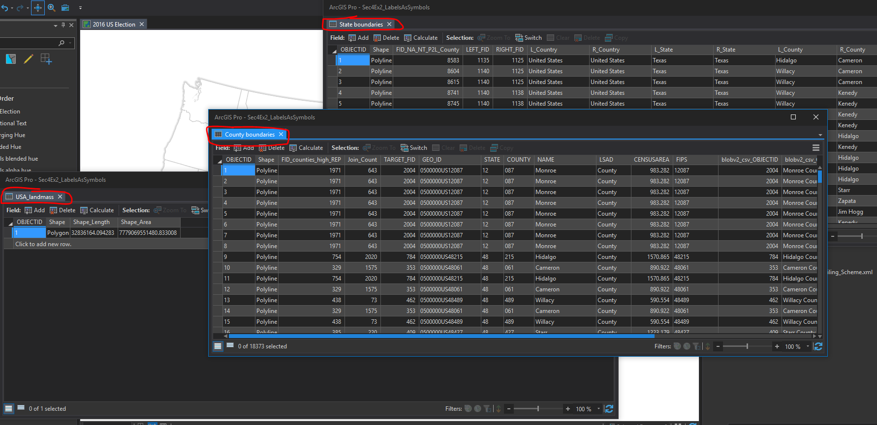

I'm not sure which version you're referring to - could it have been ArcView?  In ArcMap (at least in the 10.x versions) I don't think this has been possible.  While we can open multiple tables within the table window, there is only the single table window and I can't tear them apart and move each table independently.
But the new framework for ArcGIS Pro does allow this.

Closing this idea as the requested functionality is possible in ArcGIS Pro.
