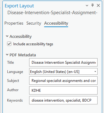

In ArcGIS Pro, you have the option to add metadata and accessibility tags to a PDF export. It would be lovely if the information that you enter the first time you export a PDF is somehow cached so that it will automatically be populated when you need to export it again in the future.
Using screenshots to explain, here is what I filled out for my PDF export the first time:

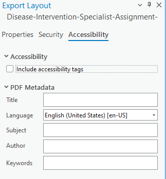

If I need to make a minor change to the layout and then export it again, this is what the Accessibility tab shows:
I'm not sure what would be involved with caching the metadata, but at the very least, it would be nice to have the option to check "Include accessibility tags" by default.

AubriOtis
Just an update, as of ArcGIS Pro 3.1 the include accessibility tags checkbox is on by default.

AubriOtis
This is available with export presets in later versions of ArcGIS Pro 3.x
