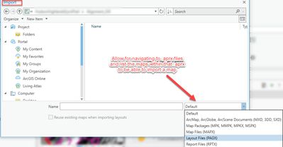

It would be really helpful if the Project tabbed panel in ArcGIS Pro (which simulates Catalog to a degree) was able to “see” into other APRX documents to the map frames and layouts they contain.  Imagine you are working on a project in ArcGIS Pro, and you want to browse through some of you previous map frames and layouts created in other projects.  You could just navigate to the project and expand it to see a tree view of the maps and data frames inside.  At this point, you could drag and drop them into your project (copy / paste) instead of going through the import process.  Since we are not able to have more than one instance of ArcGIS Pro open at a time, this would be very helpful.

In the Import Map button of a Pro project, allow the user to navigate to another .aprx, view the maps in that project and import it.
Already we can:
1. Copy/paste maps from a project to another. But, that requires I open the other project completely before copy/paste.
2. Import a map file (.mapx). I could export the map as a file and import those in with the Import Map button.
It would be convenient to see the map objects in an .aprx and choose which one to import instead of having to do these intermediate steps (open the other project OR export the map to a map file)

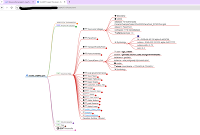

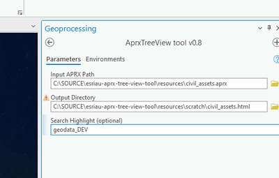

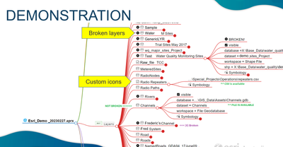

We have developed a .pyt tool that renders an .aprx file as a visual "tree" (mind-map-like) in a browser tab.
It instantly transforms your ArcGIS Pro file (.aprx) into an intuitive, interactive HTML tree-view.  With everything laid out on a single page, this tool provides a clear snapshot of your project’s structure—showing groups, layers, data sources, filter queries, URLs, symbology, and more for quick and easy inspection.”
Due to legal reasons and to comply with our IT Security complicance, I am unable to share the .pyt file , but if anyone in the Esri community is interested, feel free to comment below.
