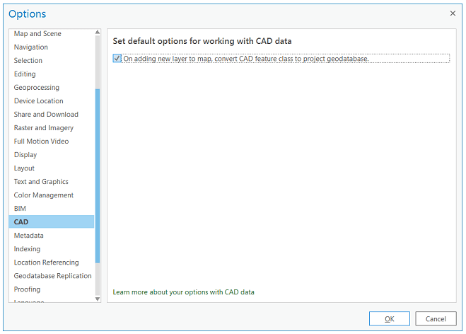

In ArcGIS Pro 3.0, this ability was removed. See the documentation:
https://pro.arcgis.com/en/pro-app/2.9/help/data/cad/cad-options.htm
This was a very helpful feature that automatically converted the CAD (dwg or dgn) drawing into separate feature classes based on the CAD drawings level or layer. I know that that "work around" is to use the geoprocessing tool of CAD to Geodatabase but this is very simplified compared to what it used to do. This tool only breaks down the CAD layers into very generic points, lines, and polygons with dumbed down symbology.

Thanks for posting this idea. Our reason for removing the setting in the Options was due to instances where the authored CAD content was not geolocated. For these instances, the automatic conversion option in ArcGIS Pro led to user frustration with GIS features needing to be translated, rotated, scaled.
In other words, this led to instances where users had to manually carry out each step of these transformations to GIS features rather than being able to use the CAD Georeferencing toolset.
We are working to motivate geolocation best practices when authoring CAD datasets. To prevent those instances described above that resulted in user frustration, we are holding off on reintroducing the option.
