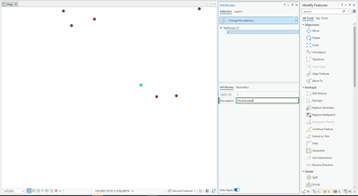

When editing a selected feature, and then trying in a text field from the attribute window, ArcGIS Pro does not keep the text if the feature is unselected while the carriage is active.  This is causing loss of work if the user does not explicitly press "enter" after typing.  Is the "Auto Apply" feature not working for text or is this a bug?

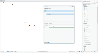

2. Do you see any difference in the behavior if the Attribute pane is floated vs docked?

1.  It happens when I click another feature.  I dont press Enter or Escape before clicking something else.
2.  It only happens when the window is floating!  Very strange.
It doesnt seem to happen to fields with a domain dropdown picklist.  It saves my choice.
