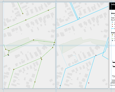

Please add this functionality! I would like to export a map series of parks where infrastructure exists underground. I would like to display the information in a side-by-side view rather than on 1 map so that the viewer can clearly see the data without any overlapping points and lines.
I think the only way to achieve this currently is to use bookmarks. My current workflow will need to be: create 1 bookmark for each park. In layout view select map 1, activate bookmark 1, select map 2, activate bookmark 1, export PDF.  Repeat until all locations have been exported.
