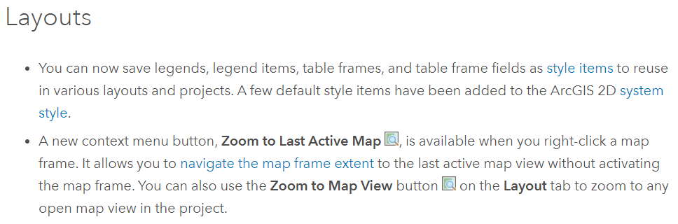

haven't used it myself, but apparently this is available in ArcPro 2.9 (skip ahead to 6:20 in the video)
Ideas in ArcGIS Pro 2.9 - Esri Community
KoryKramer
Status changed to: Implemented

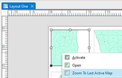

As @SarahHartholt just noted, ArcGIS Pro 2.9 brings a new context menu button, Zoom to Last Active Map.  See that What's New help topic, Layouts section.
Also check out Ideas in ArcGIS Pro 2.9 to see everything else you can expect in 2.9.

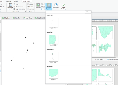

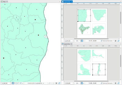

In this simple example, there are two layouts, each with four map frames. I could just as easily have 10 layouts with any number of map frames.
So when in the Map, what you're asking for is a command that would allow you to either 'zoom to last active map frame' (the opposite of this command):
And also to have a 'Zoom to Map Frame Extent' gallery (the opposite of this):
