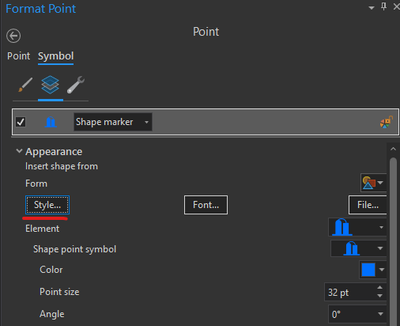

I found a way to accomplish this (I'm using ArcPro 2.9.5)
  1. Create a new, blank, empty layout
  2. Insert a graphic point symbol onto the layout
  3. Double click on the point you created on the layout and in the "Format Point" > Symbol > Appearance box select the "Insert Shape from Style"
  4. Select the Shape Style you want the graphic point to use and click OK
  5. Now, Export the layout to PNG with the following options selected
    • Clip to Graphics extent
    • Transparent background
You should now have a PNG of the Style Shape that has a transparent background.
