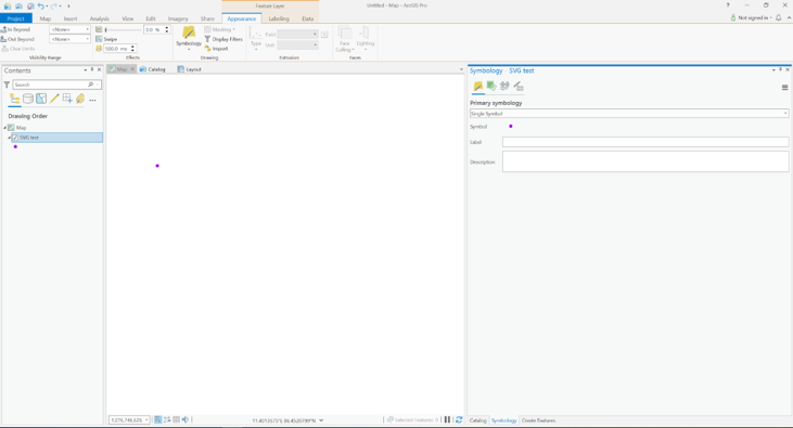

  3. Create a single point in the map window, and save edits

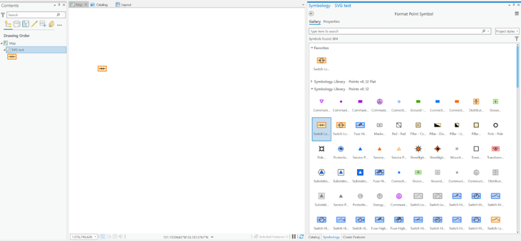

  4. Go to the Appearance tab > Symbology > Single Symbol
    1. The Symbology pane will open
  1. In the symbology pane, next to Symbol, click on the symbol icon
  2. Navigate to the symbol in the library that you want to convert to SVG and select it.
    1. the point in your map window will update with the selected symbol style

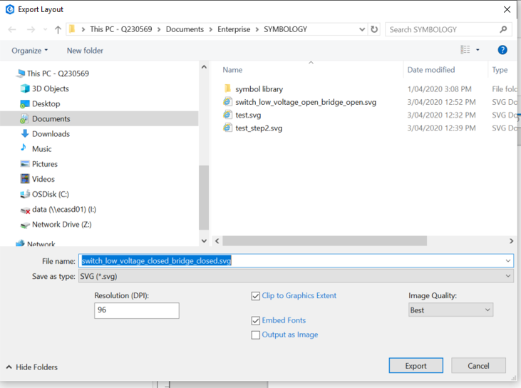

  1. Click Share > Layout
  1. Change the ‘save as type’ to SVG (.svg), keep the resolution at 96 DPI, and set Image Quality to Best

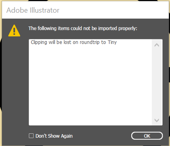

  3. Click and drag the SVG file into the adobe illustrator frame
  4. Accept any warnings

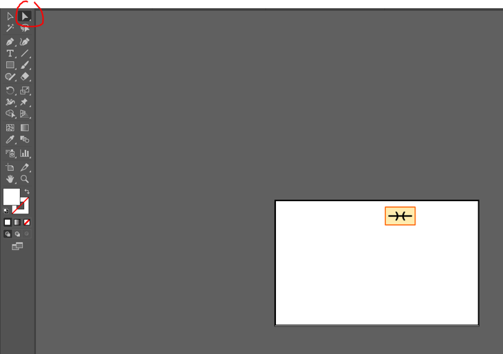

  1. You will see the extents of the map frame in Adobe, with the one symbol within the frame
  1. Click the ‘direct selection’ tool from the tool bar > click on the white mapframe > press delete on your keyboard. This will get rid of the background layer. NOTE: The page will still appear the same as before
  1. Ensure the direct selection tool is still active, and click and drag a box around the icon. ensure there are no background layers select (selections are indicated by highlighting the vertices in blue - screenshot below)

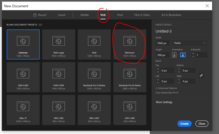

  2. Go to File> New
  3. In the New Document window, go to Web > Minimum and click Create

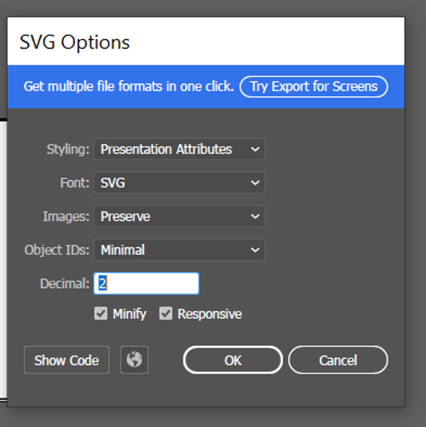

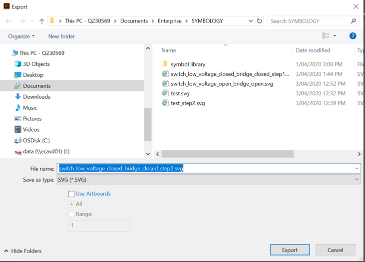

  2. Go to File > Export > Export As and in the export window ensure SVG is selected as the export type. Click Export
  1. A new window pane will appear for SVG Options. Ensure the following settings are set, and click OK
  • Styling: Presentation Attributes
  • Font: SVG
  • Images: Preserve
  • Object IDs: Minimal

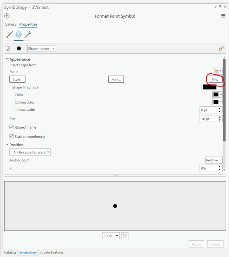

  1. Go back to ArcGIS Pro, and select your existing Map window

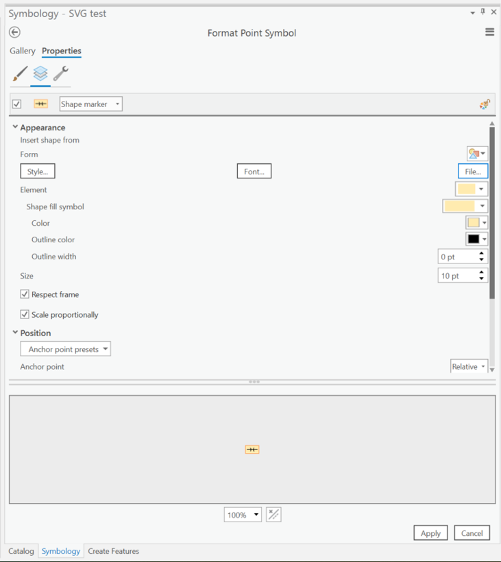

  2. In the symbology pane, next to Symbol, click on the symbol icon
  3. In the symbol library select a simple symbol style (simple circle) and go to the Properties tab
  4. Under Appearance, click the File button
  1. Navigate to the SVG file youve published from Adobe Illustrator and click OK

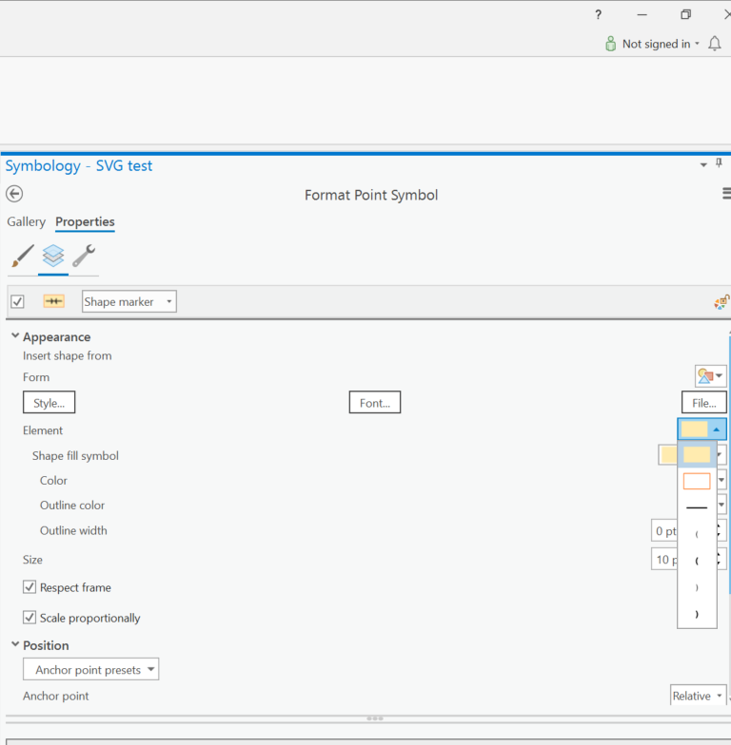

  2. The SVG symbology file is imported into the symbology pane
  1. Click on the icon next to ‘Element’ to see the drop down of every element within the SVG, and the ability to edit each element individually
  1. Click Apply for the symbol to appear in the map window
