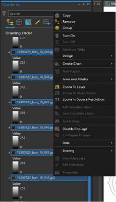

So when I am working on many orthophotos to add to my ArcGIS Pro to review, and what I find is there none to make it easier to do.
So when you create a Group Layer to add many images.  When you highlight (blue ones) and then right  click to open the context menu, there is no collapse or expand groups to turn it on.  The only thing I see is the feature is the  "Turn On". This is only when you tell ArcGIS Pro  to turn on all the images.
Please can you add them ?

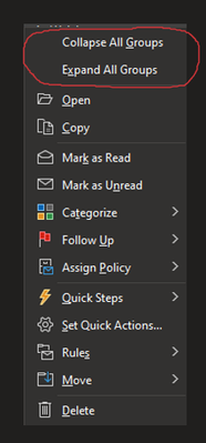

Here is an example from Microsoft Outlook, It has these features and it is a life-saver when you have so many emails.

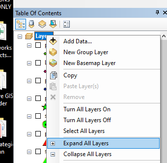

I would like to see the "Expand All Layers" and "Collapse All Layers" functionality when you right-click a Group Layer such as you get in the TOC when you right click the "Layers" group heading (Layers for the active data frame).

MatthewStull1
I will also 2nd this idea.  It was a handy tool in ArcMap (as I show in the screenshot below).  Thanks for posting it.
