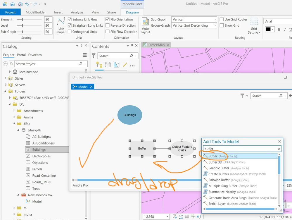

I would like to suggest enabling drag\drop property while adding tools in the model builder such that we stick them in the place we need. Currently, tools are added by double clicking them and thus they are placed behind the tools pane or on other places.
Is this by design or something that can be enhanced?

My idea here is to be able to drag\drop the tool form the list offer on the canvas as shown in my screenshot

Jamal - in Pro 2.7, like Shitij mentioned above, when the tool is added to the canvas, it will be offset so that it is not behind the search window.  While it is not explicitly a drag/drop from the search window onto the canvas, we hope that this improvement will resolve the frustration.
