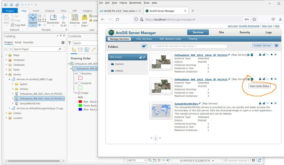

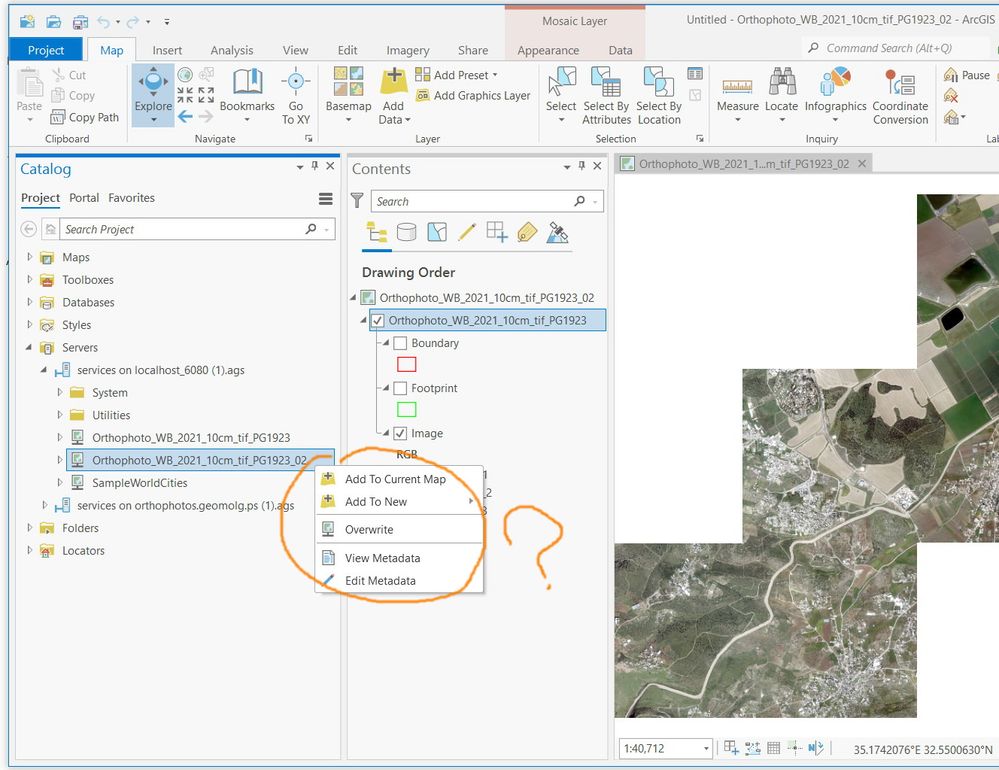

It would be great if the “view cache status” tool gets available in ArcGIS Pro

Has anyone figured out how to do this yet? I'm currently on Pro 2.6.2, can't upgrade past that yet unfortunately.

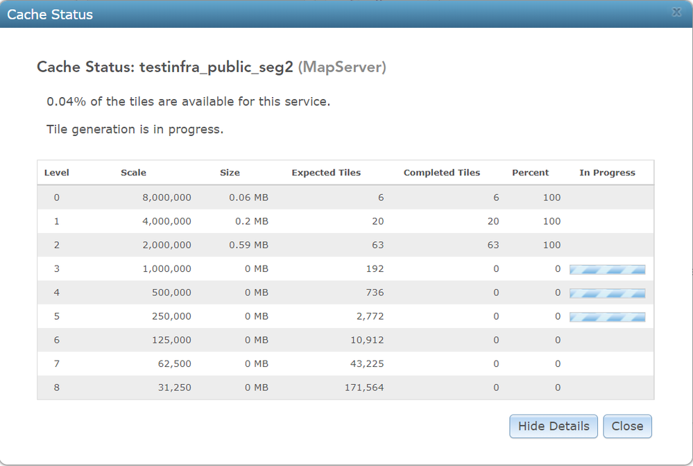

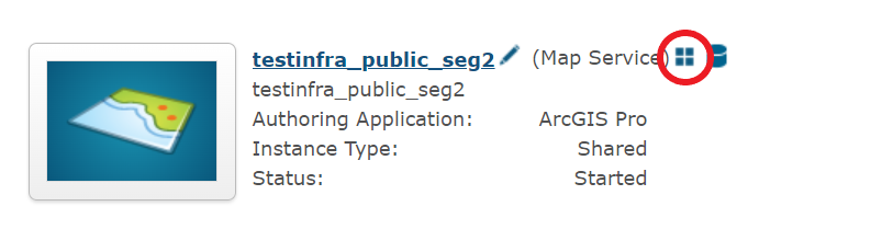

I discovered that you can view the cache status in ArcGIS Server Manager:
To be honest I liked more how things were organized in ArcGIS Desktop.
RobinCCOB
Thanks for the tip @andrei_ste ! I still don't like the fact that I have to open server manager just to view the cache status while running the geoprocessing tool to manage the cache status, but at least it's possible. I agree with you though, I preferred the options available in ArcGIS Catalog. Job status completion percentage alone is not enough. I'm still hopeful they will add that option into Pro.

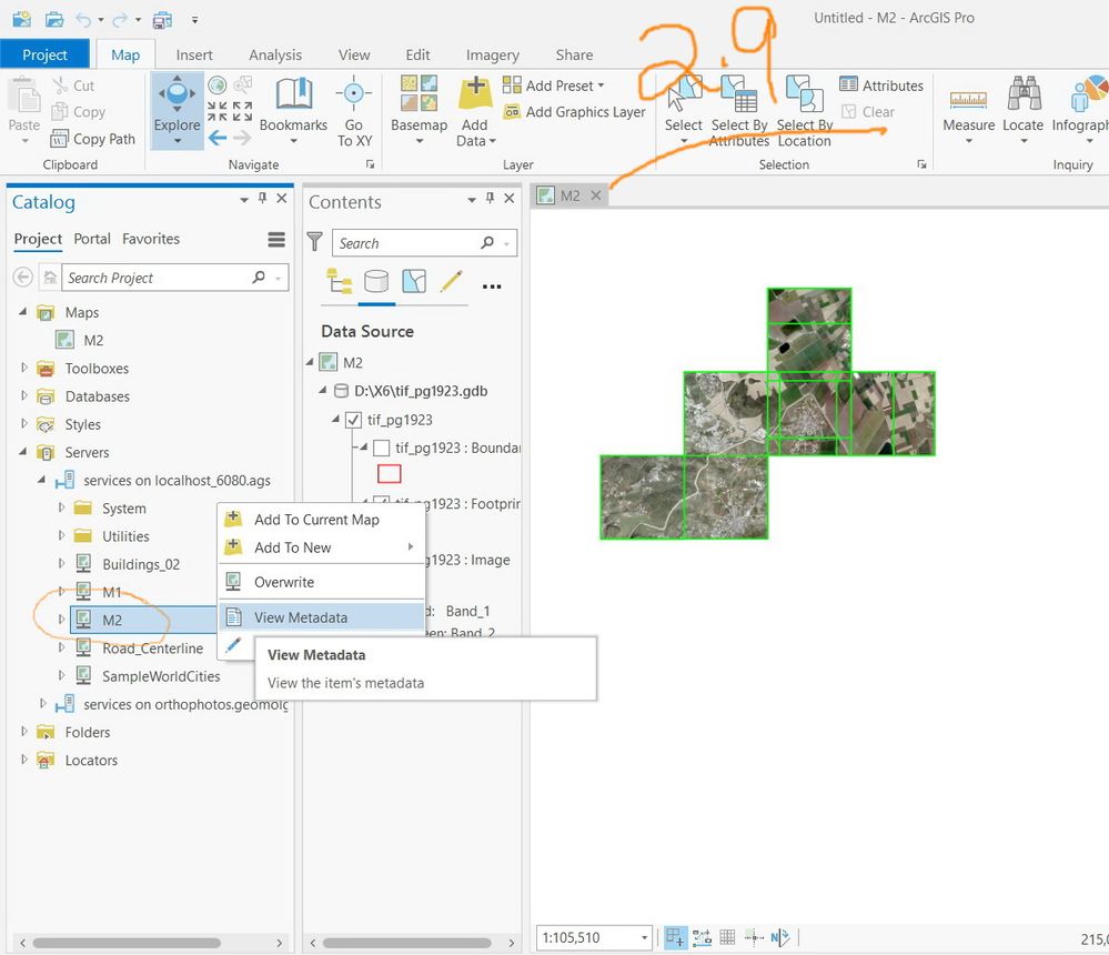

This appears not to be available in 2.9

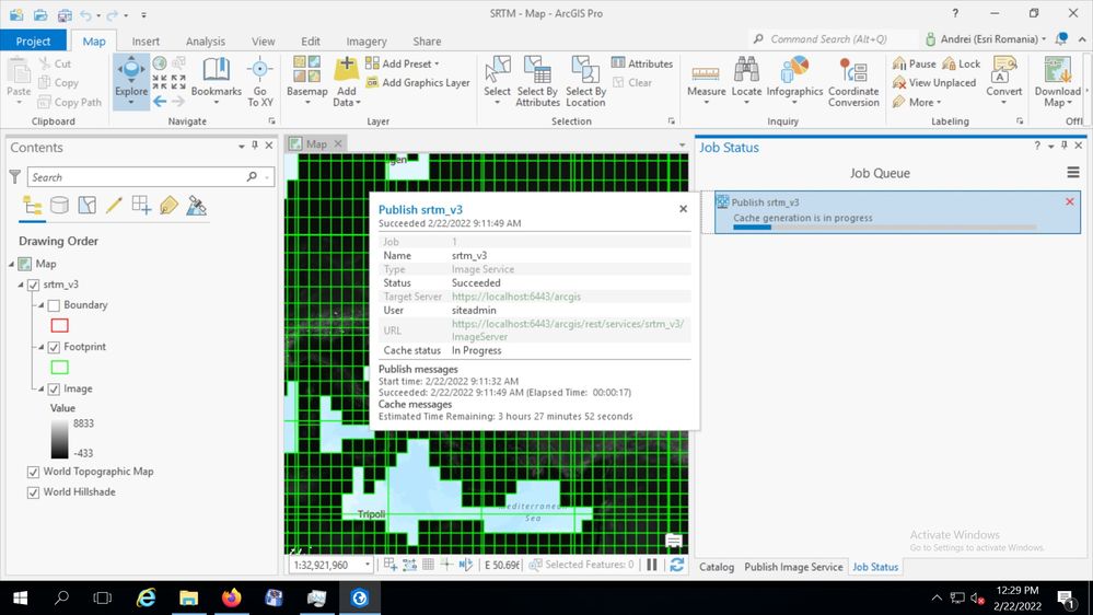

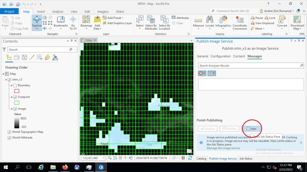

I discovered that when you publish a map or image service and you set up the cache properties, the map or image service is added to the Job Queue where you can view the cache status like the documentation says: https://pro.arcgis.com/en/pro-app/latest/help/sharing/overview/sharing-job-status.htm
If you click the Jobs button in the Publish Image or Map Service:
The Job Queue panel will open and you can view the cache status over there with estimated time remaining and percentage completed:
I am using ArcGIS Pro 2.9, but I think this option is available also in earlier releases.
