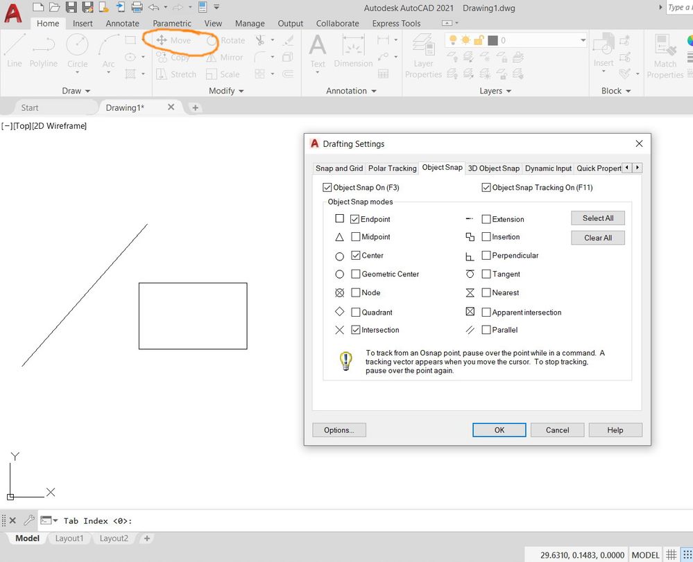

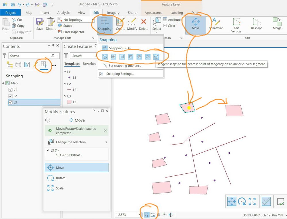

It would be great if the ArcGIS Pro is enhanced to be able to get features snapped at moving without the need to work with the anchor point. This is how AutoCAD works, for example.

Just making sure you are aware that pressing down the CTRL key and clicking on any vertex of the moved feature would move the yellow anchor point which is snappable.
JamalNUMAN
Thanks AmirBar-Maor. Sure, I’m aware of that
The issue is initially discussed here:
ArcGIS Pro 2.7.2: How to move a feature to snap to another feature in another layer without the need...
