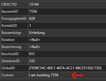

Popup:
You just can't use FeatureSetByRelationshipName(), because that relies on Relationship Classes, which you can't create for a view.
