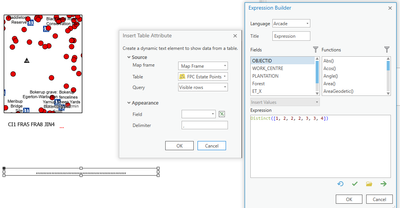

LindsayRaabe_FPCWA
@CraigWilliams  I'm not sure this works correctly in the Dynamic Text function. As per screenshot below, I don't get any values returned - just the delimiter.
LindsayRaabe_FPCWA
Support case lodged. #02745001 Removing duplicate values using DISTINCT arcade function in table value dynamic text not working
LindsayRaabe_FPCWA
Just received this update;
"Thank you for your patience as we have investigated this issue. I just wanted to update you on this case. After extensive testing, it does appear that there is an issue with the Distinct function when used in the Table Attributes option for Dynamic Text. We were able to replicate this issue and found that a blank output was returned when applying the Distinct function as outlined in the Esri Community post that you sent through.
Because of this, we have lodged a bug on the issue BUG-000137676: Unable to remove duplicates using 'Distinct' Arcade function in Table Attribute Value Dynamic Text in ArcGIS Pro. "
Hopefully see a fix in 2.8!
