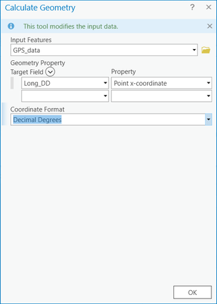

There's an easier way of converting DMS to DD without using Arcade, If you are after a quick solution in ArcGIS Pro.
1. Create two new fields (eg., Long_DD and Lat_DD)
2. Right click on Long_DD field > select Calculate Geometry
3. For the Property > select Point x-coordinate
4. For Coordinate Format, select Decimal Degrees > Ok
Do the same for Lat_DD, selecting Point y-coordinate.
and if you're looking into automating, you can use python:
arcpy.management.CalculateGeometryAttributes("GPS_data", "Long_DD POINT_X", '', '', None, "DD")
arcpy.management.CalculateGeometryAttributes("GPS_data", "Lat_DD POINT_Y", '', '', None, "DD")
