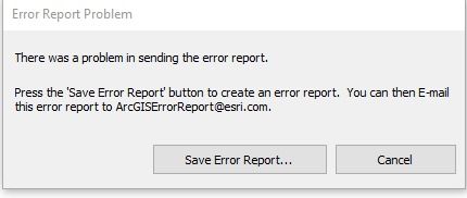

AroldoRocha
Hi everyone.
I'm following this topic because I had Pro 2.9.0 crash now, when was sharing a layout to PDF.
Every time I proced this, the crash happening.
When I try to send report, its doesn't work too, as picture.
Any hint about this?
