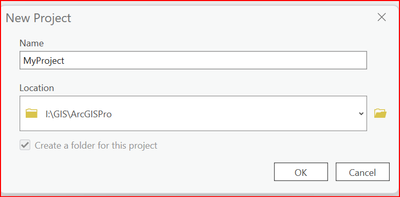

I would like ArcGIS Pro to allow the "Create new folder for this project" box to be unchecked when creating a new project from a custom project template.
Currently, the "Create a new folder for this project" box is checked and greyed out when creating a new project from a custom template.
This is a problem for us as our organisational standards have this unticked by default, meaning that if we implement project templates, any projects using these will end up with a different folder structure.
Screenshot from training video showing the box greyed out and therefore it is unable to be unchecked.Screenshot from training video showing the box greyed out and therefore it is unable to be unchecked.
Having this box unchecked is the default setting for our organisationHaving this box unchecked is the default setting for our organisation

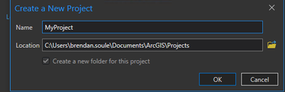

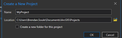

Interesting update on this.
We are running Pro 3.0.2 on one server and can uncheck that box.
However, Pro 3.1.2 on our other server does NOT allow "create a new folder for this project" to be unchecked.

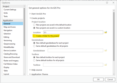

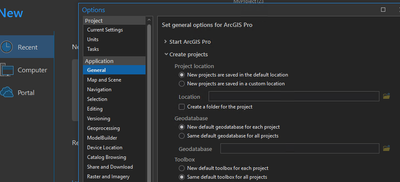

Both servers are starting with the same template APTX file, both versions have "create a folder for the project" disabled in the APRX Options:
