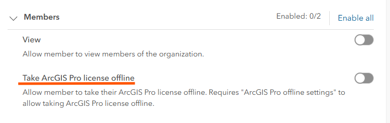

Hi @AdrianHughes3
The functionality being requested has been implemented through a privilege called "Take ArcGIS Pro license offline." If the organization turns on the Members cannot take ArcGIS Pro offline setting in Manage ArcGIS Pro settings , it overrides this privilege.
You can learn more about privileges here: Privileges granted to roles
PatIampietro
@ValeriaChavez while I applaud this implementation, a quick check of my user role settings reveals that this new privilege is turned on by default for all roles!
As I understand your explanation above, that will not have any effect if the organization-level "Members cannot take ArcGIS Pro offline" setting is turned on (for which I am thankful), but in order to take advantage of this capability to selectively allow only certain users the privilege of taking ArcGIS Pro offline, my workflow should be:
  1. Turn off this new privilege at the User Role Level for all existing roles
  2. Turn off the "Members cannot take ArcGIS Pro offline" setting for the org
  3. Create a new User Role with the new privilege to take ArcGIS Pro offline turned on (as well as all other desired privileges). Alternately, if there is an existing role that includes only those members I wish to allow taking ArcGIS Pro offline, just use that one.
  4. Assign this role to the desired current and future users
Is that correct? Some clarity would be helpful. In any event, granular control of this privilege has been a long time need, so thank you for implementing it!
