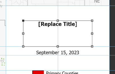

I commented on the original question back in 2020 and came back to see if there was a workaround available yet, since the issue still exists in Pro 3.1. Adding my use case for this functionality here, in addition to the one I posted there.
I am automating standardized cartographic product production in Pro via a Python script. All maps will be exported from a single layout, which has a title and a date as shown below. Sometimes the map title will be longer; sometimes it will be shorter; in cases where it is longer I would like it to wrap multiple lines, so I'm using the rectangle (as opposed to straight) text element.
Emulating the layout for the manual process I am replacing, I would like the title arranged just above the date stamp below it (screenshot below), regardless of whether it wraps at 1, 2 or 3 lines. I could achieve this if I could vertically align the text at the bottom of my box. As it is, if the title is only 1 line, there will be a big gap between date and title (smaller gap if it is 2 lines), and if I don't implement a workaround I know the client will wonder why the layout looks awkward for short titles.
For the time being I will probably implement a two (or three) text element solution, pythonically checking the length of the title string for a given map and then toggling the appropriate element's visibility on and replacing the text for that element. Or guess I could just change a single text element's height pythonically too, depending on string length.
Hope this helps! Look forward to seeing this implemented in the future. I do understand that this is (probably in most cases) a minor cosmetic issue so may not be the highest priority. But glad it is on the list of fixes under consideration; I routinely encounter instances where it will be great to have available.

@MarkJacobi1, I believe you could achieve the functionality you are looking for in your example with the straight text element vice the rectangle text element; straight text keeps the box exactly the size needed to contain the text in it (but will not wrap dynamically; it will only wrap if you explicitly insert a break in the text in the element pane):
MarkJacobi1
Thanks AlderMaps!
I think that does the trick. I was working with maps converted from ArcMap and didn't realize what was happening. It seemed like there was a solution. I still miss Draft Mode but I have a new job where I mainly crunch data instead of making maps, so I don't miss it as much lately.

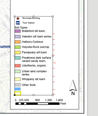

My problem on that is when working with legends. Once we convert legends into graphics, the "text" portion is turned into "Rectangle Text" by default--which cannot be resized (Please don't hesitate to correct me if I am wrong). There is no other mechanism I can find to change from "Rectangle Text" into Straight Text, which can be resized.
So it turned out to be something like...this. This absolutely drive me nuts!
(Let's be honest to yourself--as I have mentioned before--converting legends into graphics is ALWAYS the better way to customize & resizing the legend portion of the map than the rigid, inflexible method DICTIATED under the legend function. Yes, ArcMap is FAR FAR superior in this regard).
