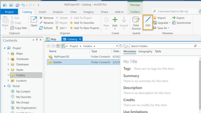

We do not plan to add this functionality – in ArcGIS Pro, a file with the *.txt extension is already being interpreted as a comma delimited table file, and can only be associated with table related operations (and not with operations for unstructured text file).  Besides what Kory mentioned above as a workaround for your need, you may also want to consider entering in the folder’s metadata your notes about the content of this folder, the results of operations you have performed on the content of this folder, and so on. To enter your notes in the folder’s metadata, select the folder in the Catalog view, and click the Edit button on the ribbon:
If you prefer, you could use just the Description field of the folder metadata to enter your unstructured notes.  For more details about how to use the metadata editor, please see https://pro.arcgis.com/en/pro-app/latest/help/metadata/view-and-edit-metadata.htm .
