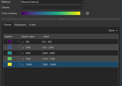

When symbolising quantities, and classifying using the manual method, you can't change the number of classes. The classes box is greyed out, so you can't click on it, and so is the right click option to insert a break. If you need another class the only way i have found is to change the method (wiping all the breaks you have manually set), change the classes and then change it back to manual. Can we please have an option to add classes for this method?

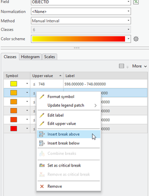

As one comment mentioned in the previous thread, this is by design. Because with customized classes, it will be hard for us to decide where to add a new one or to remove which class. Any action might ruin existing manual classifications, so we grey out the classes control.
W have this more flexible function to update classes: if you right click on a row, you can choose to add a break above or below, and this will update the number of classes and don't need to switch to another method. Hope it will help.

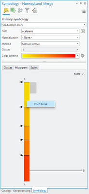

Marking this as Already Offered per Zihan's response. As she showed, you can insert break above or insert break below. You can also switch to the histogram and manually insert breaks where you need:
