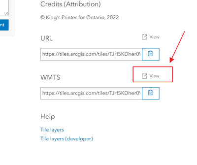

Yes, the service you mentioned above is not a webp service, this can be confirmed by the following steps:
On the item page, in the lower right section, there is a button you can click that allow you to open the WMTS service capacity page.
Search for keyword like "png" or "format". As you can see in the screenshot below, this WMTS service can only provide tile image in png or jpg format, not webp format.
Hope this helps!

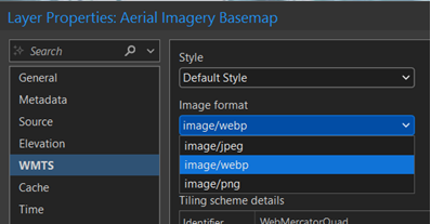

TanuHoque
Status changed to: Implemented
It is implemented in ArcGIS Pro 3.4 release. Thank you all for your suggestions and feedback.
