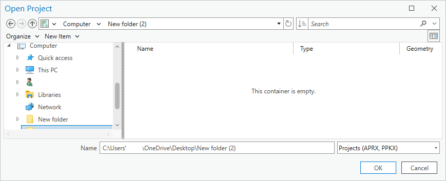

Additionally, I can't seem to use the Open Project dialog to open the file:
It's confusing that double-clicking the file in File Explorer works, but the Open Project dialog doesn't work. I would have thought those two techniques would be similar.

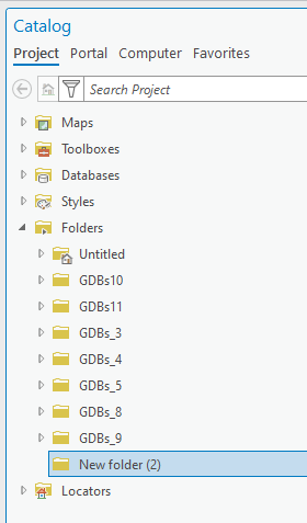

Also, I can't seem to use Catalog to open the file either. The folder doesn't expand, so I can't see the file:

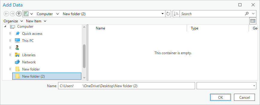

The Add Data dialog doesn't show the file either:
