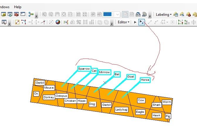

In ArcMap you can select multiple geodatabase annotations in the map that have leaders and move them around without losing the leader line anchor location. Currently in Pro you can select multiple annotations however the leader lines anchor points are also moved the same distance the annotation is moved, thus changing the object/location the annotation is pointing out.

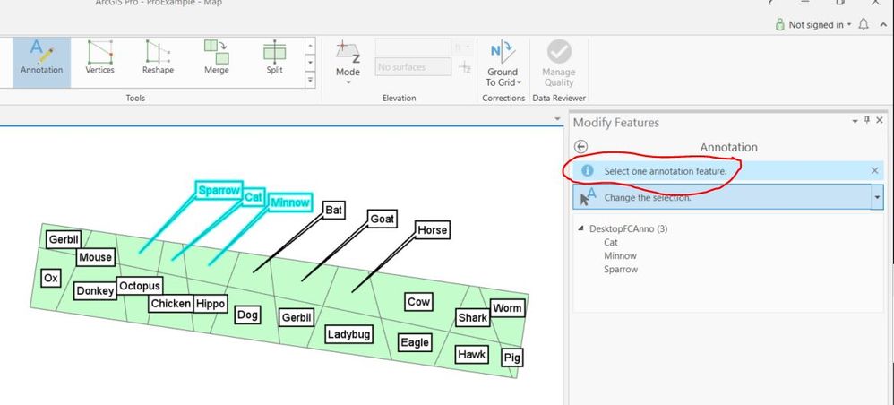

I create annotation for feature classes with hundreds of features and need the ability to select and move many anno features at once.  I have this ability in Desktop, but it appears that in Pro, you are able to only select and move only one feature at a time.  I would like the ability to select and move more than one feature in Pro like you can in Desktop.  If you are actually able to do this in Pro, let me know what I should do (I still don't have a firm grasp of how Pro works yet, lol)
😄 In Desktop: select and move more than one anno feature
>:( In Pro, can only select and move one anno feature at a timeAnnoEditPro.jpg
