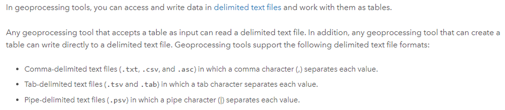

KoryKramer
This will be available in ArcGIS Pro 2.9, scheduled for release later this week.
Once the release is available, check this help topic: Geoprocessing considerations for delimited files https://pro.arcgis.com/en/pro-app/latest/tool-reference/appendices/geoprocessing-considerations-for-...
