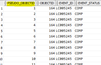

Could the various issues with 1:M (one-to-many) joins in Pro be solved by having a pseudo-ObjectID (row number) field as a unique ID?
For example, Oracle's ROWNUM pseudo-column works fine for query layers as the unique ID. Could a similar row-number-based mechanism work for Add Join in the attribute table, too?
select
    cast(rownum as int) as pseudo_objectid,
    lc.*,
pf.* from lc_events lc --one left join lc_events_project_finances pf --many on lc.event_id = pf.event_id

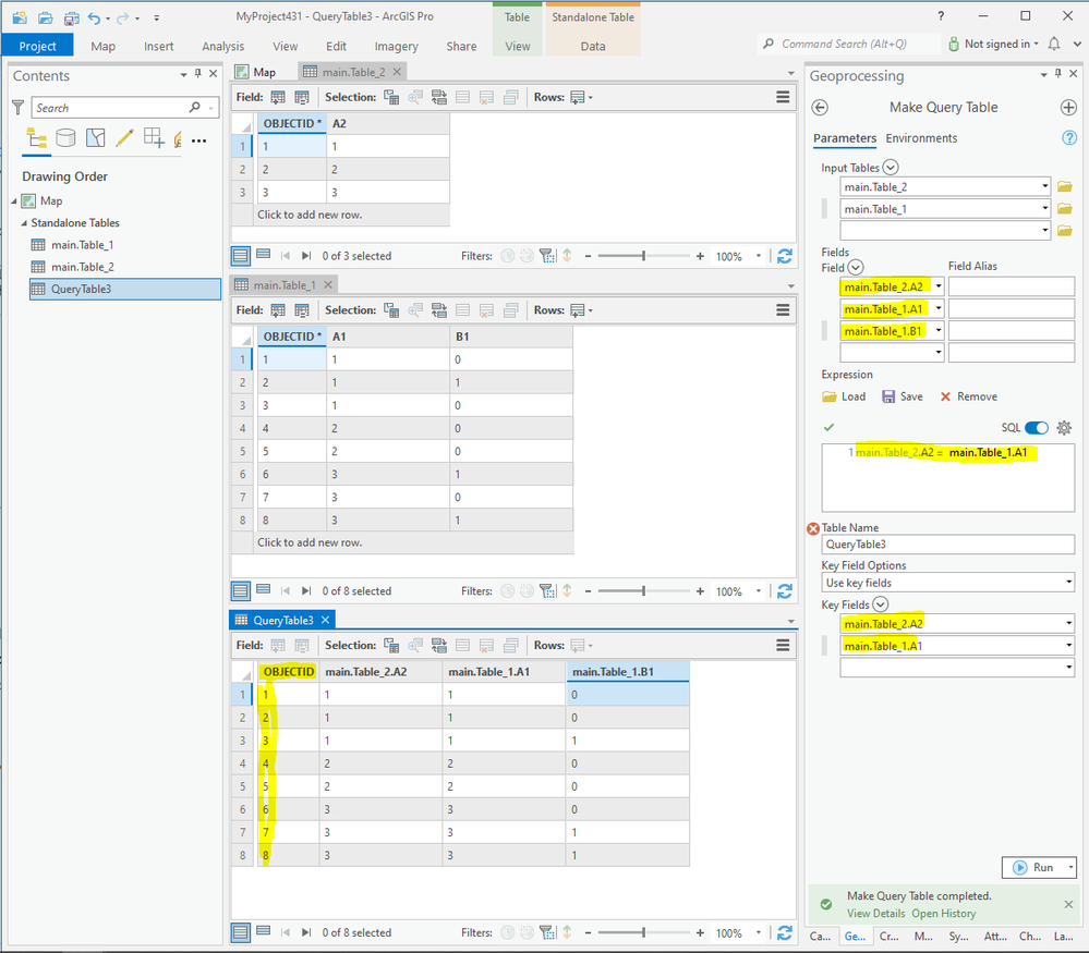

Bud
Make Query Table (Data Management)
You can provide a key field option and key fields list. This information defines how rows are uniquely identified and is used to add a dynamically generated Object ID field to the data. Without an Object ID field, selections will not be supported.
How to join using Make Query Table?
Limitation: The data in a Make Query Table can't be edited.
Bud
@JonathanNeal and @JillScholz_esri
Make Query Table has functionality that lets us generate an OBJECTID field on the fly in feature layers and table views. The OBJECTID values are truly unique, even if the relationship of the "join" is one-to-many.
Make Query Table (Data Management) > Key Field Options parameter
Generate a key field—If no key fields have been specified, an Object ID field that uniquely identifies each row in the output table will be generated.
Could the same mechanism be used in the attribute table of a proper one-to-many join via Add Join?
Would that help solve the 1:M join selection issue (duplicate OBJECTIDs)?
