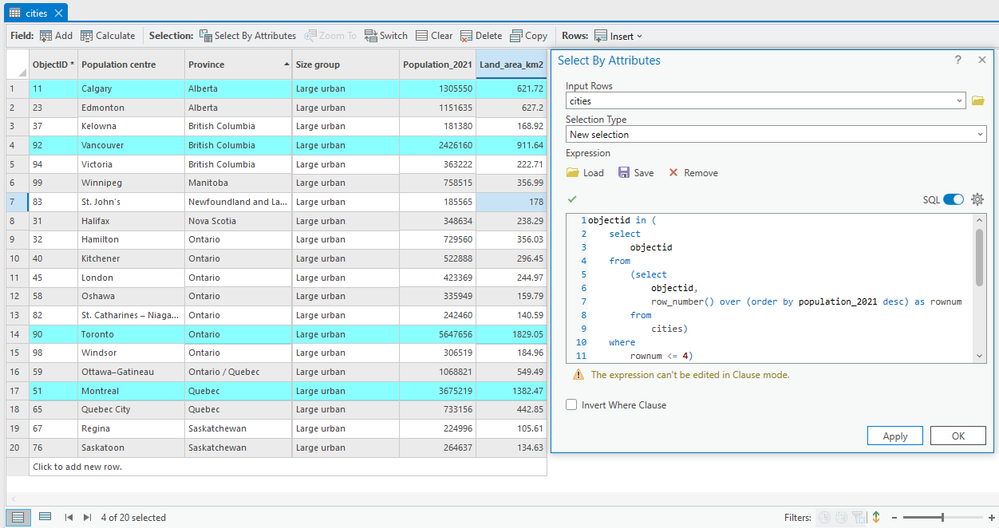

The ObjectID is static. I want a dynamic row number within a sorted query.
Like this: Select the four largest cities.
objectid in (
    select
        objectid
    from
        (select
            objectid,
            row_number() over (order by population_2021 desc) as rownum
        from
            cities)
    where
        rownum <= 4)
This works in a mobile geodatabase. And there are enterprise geodatabase equivalents. But as far as I know, there isn't a function like ROW_NUMBER in file geodatabase SQL.
