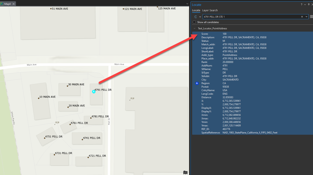

For the new primary locator roles it would be really helpful to get the input search field values in the response. This way it can be checked to matched candidate.
We are trying to use the new PointAddress and Streets Roles but getting invalid matches which did not occur in the SubAddress locator in 10.x. Due to these mismatches it would helpful to see what the input search address was so it can be compared to the result.

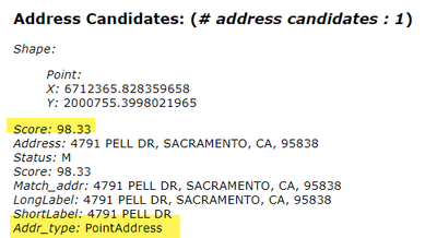

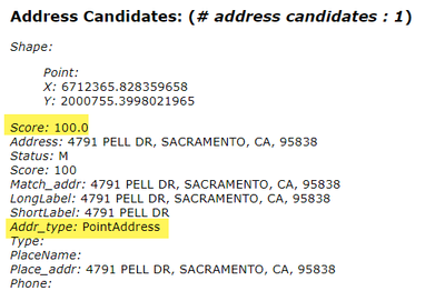

In this example below, we are entering and a single line input: 4791 PELL DR STE 1, SACRAMENTO, 95837
However the match comes back without the STE which is not correct and should not have the 100% match score.
The 10.x SubAddress locator returned no matches which is a better result but realistically there should be a candidate match with a lower score than 100.
If the search input was in the result we would easily be able to compare the search string with the match string to weed thru these mismatches.

@RonnieRichards Looking back at your original post, I would say that you should include at least 'addr_type' to be returned from the request so that you can understand the match level of the returned candidate. What is returned in the example is a PointAddress candidate and not a Subaddress candidate. If a feature that represents this subaddress does not exist in the reference data, then locator is going to return a match at the next precise match level, which is PointAddress in this case, which is less precise than Subaddress. If you are just searching for subaddress addresses, then I would suggest adjusting the Categories setting in the locator to only search for/return Subaddress by just checking Subaddress. Do you get the same result for search when testing the same locator in Pro Locate pane? Do you see any suggestions for the subaddress as you type the address that includes the subaddress element?

However I am still seeing the same match score results which is confusing. To be specific when using the PointAddress type we do get a hit on the address string: 4791 PELL DR STE 1, SACRAMENTO, CA 95838 but with a 100% score. Shouldn't the extra string elements detected as a unit type and unit number reduce scoring? Are the locator output fields documented anywhere?
It seemed to do so in the legacy locators with a match of 96.2 and a it shows in the scoring component return but using the "Locality" attribute:
Comp_score: ;House=100; prefix=100; pretype=100; StName=100; suftype=100; suffix=100; LocalityPreDir=100; LocalityPreType=100; Locality=85.63; LocalitySufType=100; Admin=100; Postal=100
Its seems like PointAddress scoring is only reduced when other elements are not perfect like the street name or postal city, so could extra the unit information be considered in the overall match score? As illustrated it did in the legacy locators and helpful to know the input string was not an identical match to the candidate. The scoring components are also very valuable as well and hopefully they will be incorporated soon.

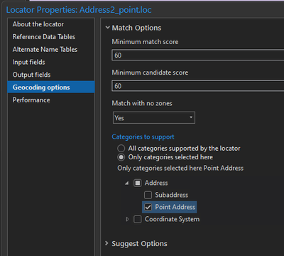

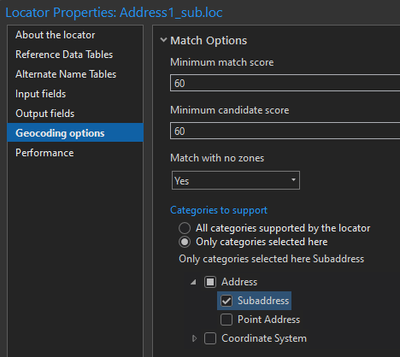

@ShanaBritt Thanks for all the information related the PointAddress and the catagories over the years. We are having some success over here but only when we separate the PointAddress locator into 2 (one for each category). Then configure both PointAddress.subaddress & PointAddress.PointAddress into a composite locator.

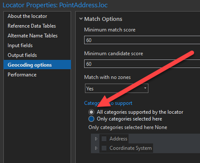

The strangeness is when these categories are combined which is the default nature of create address locator, we still see 100% match for some addresses with units which do not exist in reference data. This is confusing as a default option and would assume most users would not want 100% match for a candidate which did not exist. As we tweaked the input we did get some scoring to diminish but not with the same scoring as when they are combined into a composite.
Default Result = Address inputs candidates with units which do not exist in reference are getting 100% match to PointAddress.
Individual - If the same locator is broken apart by category (subaddress vs PointAddress). Then result from PointAddress has a reduced match score (as expected it does not exist in reference).
Example: 4791 PELL DR STE 1
Should these results be the same regardless of the categories chosen?
I think our agency can move forward with this configuration we have fallen into but this seems confusing especially when differing results are returned when combined at the categorical level vs composite.

@RonnieRichards , Thanks for the additional info, however, I still do not know what the reference data used to build the locator looks like and it seems like I am missing some other details about the composite locator. Based on the info you have provided the address "4791 PELL DR STE 1" does not exist in your reference data, so the next best match is to the base address of "4791 PELL DR", where 'Ste 1' is ignored and may possibly show in the ExInfo output field as a part of the string that was not used or could not be matched to any part of the address. Since "4791 PELL DR" exists in the data the input address matches every other part of the address when 'Ste 1' is ignored. This is expected behavior. If you set the Out Fields parameter to all (asterisk) in the findAddressCanidates REST request you will get all of the output fields from the locator, which includes the ExInfo field.
Does the composite contain the same locators that references the same data with just Subaddress category disabled or enabled? What is the Result Order used by the composite? Does your data contain any subaddress features? If not, any input address with a subaddress will get matched to the base address if it exists in the reference data.

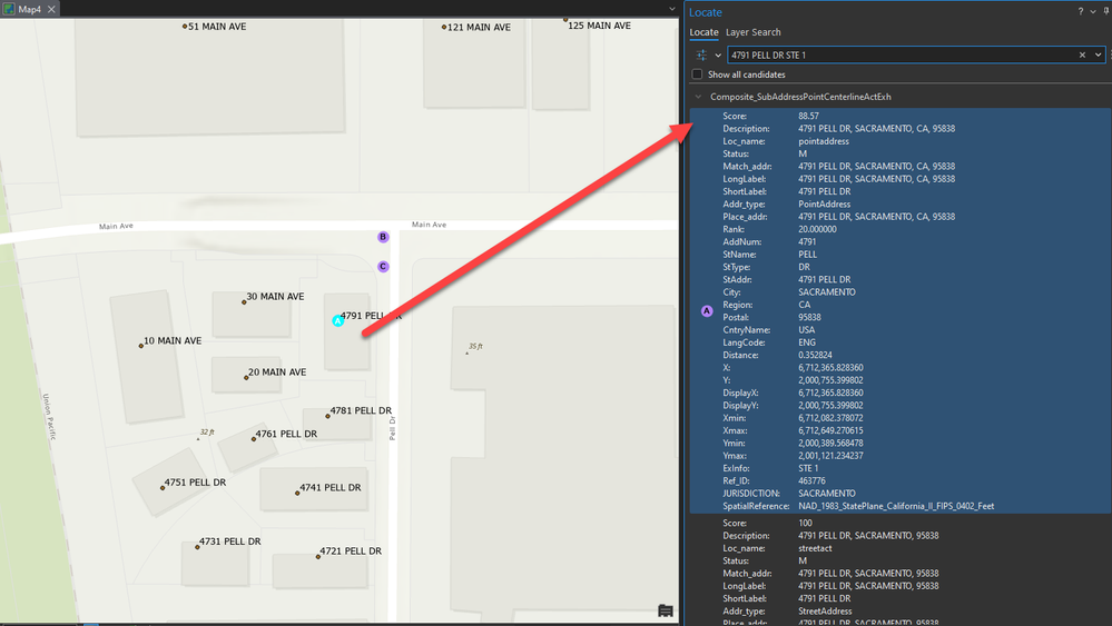

Everything you have captured is correct, the suite in this example does not exist. The matched record against pointaddress category does indicate the Exinfo = STE 1. This is being described as expected behavior and understand getting an appropriate match. But  with these results I am more concerned about the scoring, specifically a 100% against subaddress/point address categories but lower scores when incorporated into a composite.
The composite is using the same locators, except just singular categories enabled in each. The result order in the composite is subaddress, pointaddress and then street range.
Yes some of the reference data does contain sub address features
Pro 3.1.2, Enterprise 11.1 - However these results are clearly exposed in Pro and have reference data/locators available if you need to test this further to understand.
Using the pointaddress role with both categories enables returns a 100% match but no ExInfo
Using the pointaddress role with one category enabled  and the second category enabled and then stacked into the composite returns the same match candidate but the score is reduced as expected. This does contain the Exinfo as you explained.
