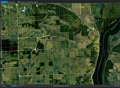

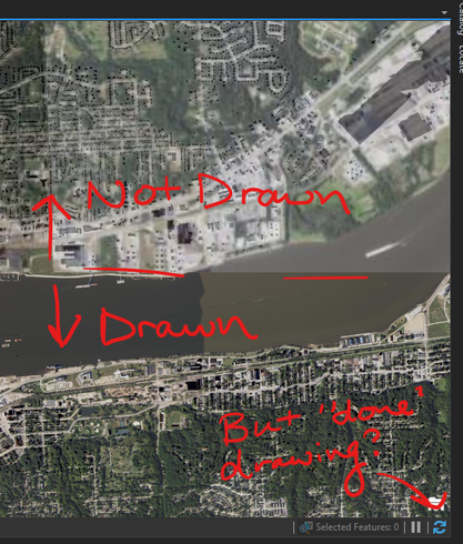

ArcGIS Pro is much better at not cancelling the drawing of your map than ArcMap. However, it still happens:

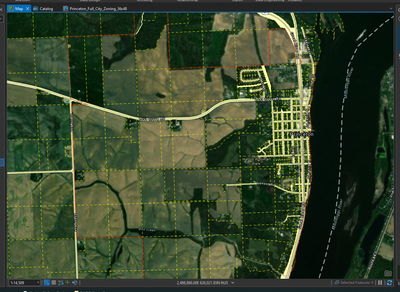

What's worse is that there's no indicator that this is happening as there is in ArcMap:
I'd like to see some sort of indicator, whether it's that same 'Canceled' label appearing somewhere or adding a new icon to that status bar that shows as a green checkmark/red cross type of thing. I could see the argument for a temporary green check appearing when it's done drawing, and a persistent red x if there are errors.

In the case you're presenting above, if you mouse over the view or interact with it at all does it continue drawing?  Pro does "cancel" all the time when you're interacting (e.g. cancel requests that were made if they're no longer needed) to improve responsiveness.
The "refresh" behavior of the drawing indicator is designed to allow the user to hit refresh if they feel the drawing is incomplete. Are you able to replicate the behavior you're showing above? e.g. are you able to provide a repro case for the "cancelled, but incomplete" drawing behavior without you hitting Esc?

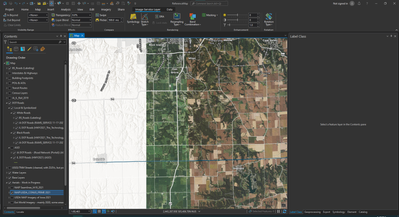

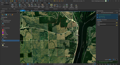

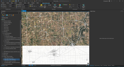

Hey @KoryKramer, I might have a lead for you - while I was loading up a map that contained this layer (https://gis.apfo.usda.gov/arcgis/services/NAIP/USDA_CONUS_PRIME/ImageServer) in a maximized Pro window, I switched to a maximized Firefox window in front of it. The map stopped loading the imagery layer. However, that doesn't seem to be the issue: even after some panning and zooming, it didn't want to appear, I had to nudge it quite a bit, and there are still instances where it'll say it's done loading but not show the imagery. No visibility ranges, either.
wayfaringrob
Oh, and yes, that's the same layer from my original post. I wonder what's going on with it.

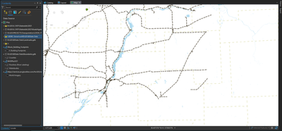

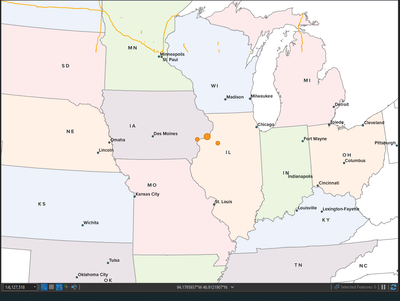

@KoryKramer  Here is another example, not sure what the issue is here. I just zoomed out with the scroll wheel and you can see the line of where it stopped drawing the railroad tracks, which are saved in the project .gdb. Counties did not draw their labels, either. I'm sure there are times this has happened in Pro that I did not notice because the indicator was removed. Restoring the warning would be very useful in circumstances where it's not so obvious.
KoryKramer

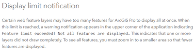

@wayfaringrob for the TIGER roads service, I got a toast notification > Display limit notification
https://pro.arcgis.com/en/pro-app/latest/help/data/services/use-web-feature-layers.htm#GUID-5C33BE0F...
Did you get that when a service stops drawing? I'm not sure about the latest example you've provided. What kind of data is in the map?

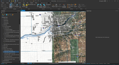

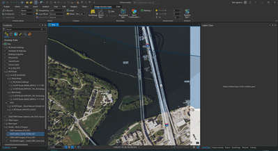

Ok, here's a parcel layer stored in a local .gdb. You can see it in the lower left portion of the map, but that's it.
It appears correctly on zoom, and sometimes if I zoom back out and move it, it'll get it to appear.
KoryKramer
@wayfaringrob we added drawing alerts in ArcGIS Pro 3.2. If you have 3.2 or 3.3 installed, can you let us know if that helps with the issue you were seeing here?
