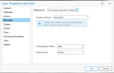

Additionally we have added the following usability enhancement. If you add the raster layer to the scene you can also open up the layer properties and select "On custom elevation surface". This will do the following in one click
1. Create the custom surface
2. Add the selected raster layer as a source to the custom surface
3. Set the elevation mode for the selected raster to the custom surface.
