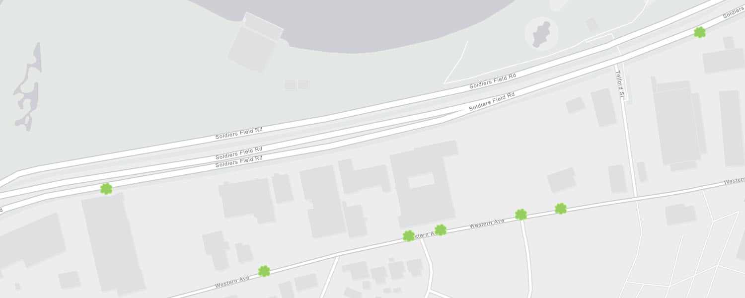

Using ArcGIS Pro, there is another method - the Disperse Markers tool. This tool finds overlapping points and spreads them apart based on a pattern and distance of your choosing. Note - this technique has been available in ArcMap for some time as a part of Cartographic Representations, which allowed you to customize the symbology of data and store these properties as a part of the feature class. Using Disperse Markers has since been simplified within ArcGIS Pro. Let me show you how I used the tool to transform a dataset for Boston street trees from this:

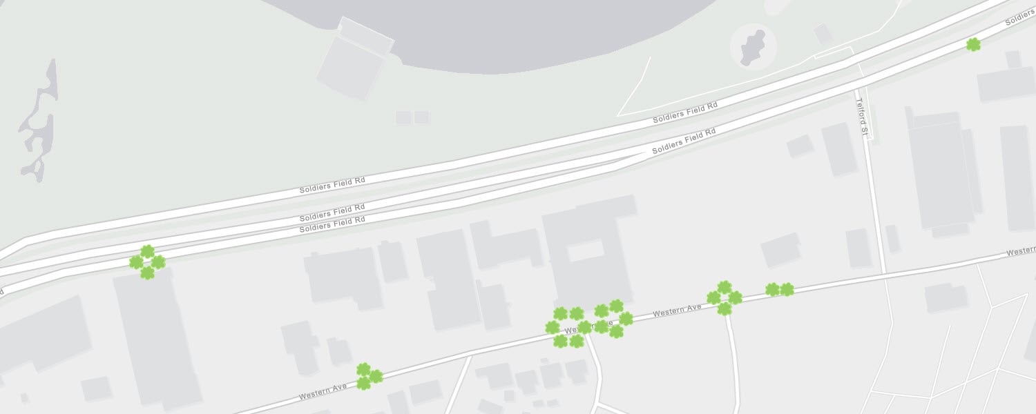

To this:

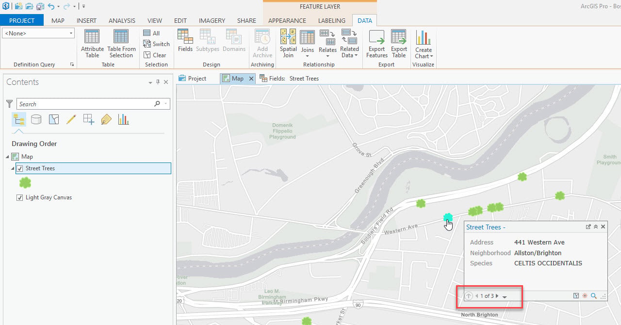

This tree data was geocoded to addresses - this resulted in multiple features at one location. The tool will help ensure I can see not just one, but all the features as individual points on the map.

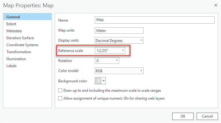

Before running the tool, you'll need to set a reference scale for your map. This means that as you zoom in and out on your map, the size of the symbols will be fixed. Since the Disperse Markers tool will use the reference scale you set to help determine the spacing, it's important to think about your desired end result. For example, in the map above, I was working on a project for an arborist who would be performing tree inspections, so I set the reference scale to be useful for his work (1:2,257, or Level 18 using the ArcGIS Online scales). To set the reference scale, right click on your map in the Contents pane and click Set Reference Scale - it will be set to your current map scale. You can view this in the Map Properties as well:
setting the reference scale
Note: after you change the reference scale, you may need to alter the symbol size. Remember - you are selecting a symbol style and size that looks appropriate at this zoom level.

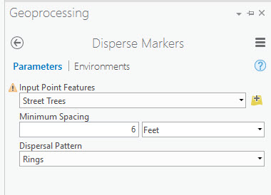

Next, browse for the Disperse Markers tool in the Geoprocessing pane. The parameters are pretty straightforward - you will select a dispersal pattern (described more in the tool help) and a spacing. Remember the minimum spacing takes into account your reference scale - so running the tool with the same parameters but different reference scales will yield different results. The parameters shown here are what I used on the Boston street trees:
There will likely be some trial and error in running this tool - maybe the spacing was too far apart, or you didn't like the pattern you selected. Remember how you made a copy of your data, before getting started? You'll need to re-run the tool off of the non-dispersed data each time - which means, make another copy before running the tool! This will ensure you have your unaltered original data, and can try different scenarios.

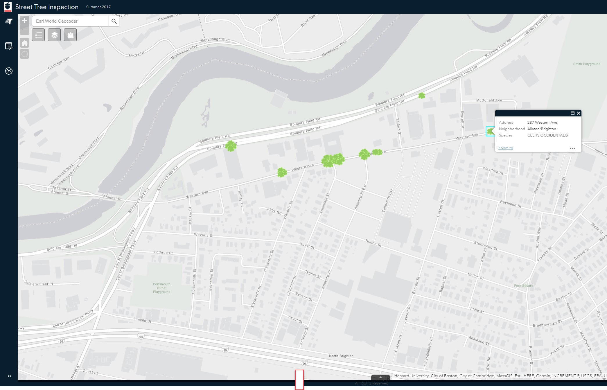

Next, I published the result to ArcGIS Online - doing this preserved the new dispersed point locations, making my data useful across the entire ArcGIS platform. From ArcGIS Online, I build a Web AppBuilder for ArcGIS application that was used to demonstrate filtering, web editing and routing capabilities that could help the arborist be more efficient in his work. The dispersed points make it much easier for him to select the appropriate trees for viewing, editing and routing.
