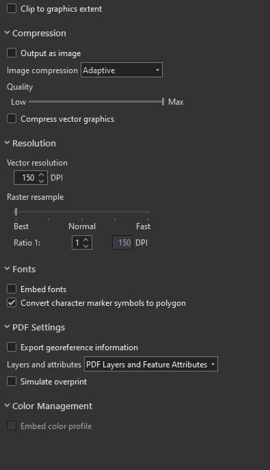

I've been having issues with exporting to PDFs as well, it looks like it exports fine but my coworkers cant always see it and we cant combine a new PDF with another PDF, the new PDF just shows as white. this is a major problem for me.  I havent tried a new project yet, my data is from my computer, shp files and from a gdb and from esri.  its a combo of ortho images and polygons.  any help on this would be greatly appreciated
CarlMorrison
I had the same issue when a co-worker tried to bind a PDF into another PDF.  I found by trial and error that these settings worked for us.
