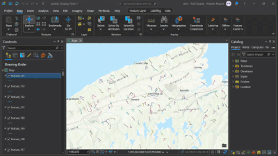

GIF showing how to change the display fieldGIF showing how to change the display field

GIF showing how to open the Python Window in ArcGIS ProGIF showing how to open the Python Window in ArcGIS Pro
Below is a script you can run to update the display field for every layer on your map. Just remember to change line #9 to whatever field you would like to use 😎.
