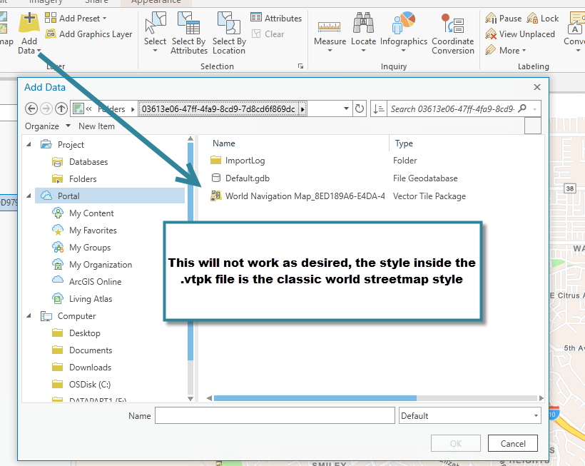

Note: the .vtpk file that is downloaded to the file system will not have the desired style.  Internally most Esri basemaps contain the World Streets Style.  If you use the .vtpk file on its own, side loaded or added to a new map and shared as a mobile map package... it will display in the world streets style.

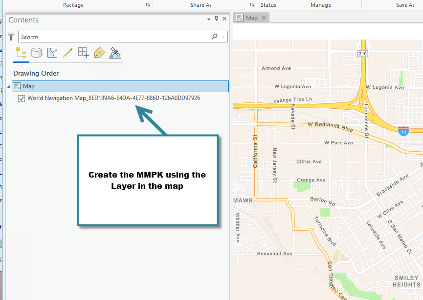

Using ArcGIS Pro 2.7 and the current version of Fieldmaps, the downloaded basemap in ArcGIS Pro can work.
When creating the  mobile map package you need to use the Layer that is added to the map.
The desired style properties are stored in the Layer.   Fieldmaps will use this style when it is available.
Browsing for the .vtpk file that is download to the file system and adding that to the map will not work as desired.
