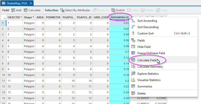

The Field Calculator in ArcGIS Pro is a key tool in working with attribute values. This is an advanced article using it with Python programming, but I’ll skim over the basics first. If you’re an advanced user who just wants the goods, skip/skim over this section.
The Field Calculator, also known as the Calculate Field geoprocessing tool, is a handy way to set the value in a field for every record in a feature class’s attribute table (or stand-alone table). The simplest way to open it is to open the table, right-click on a field, and select Calculate Field from the context menu. That opens the tool with the table and field already filled in.
You can also search for the Calculate Field tool in the Geoprocessing pane in Pro or the Command Search box in Pro’s title bar.

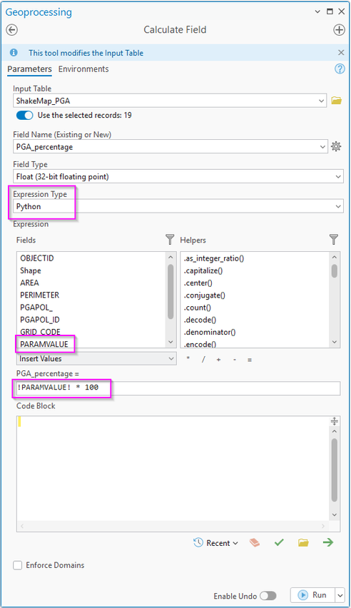

The most basic way to run it is to do the same calculation on all the values. In this example, we convert a decimal value to percentage (multiply by 100), but any Python expression works here. A field named PARAMVALUE is my input. If we double click on it from the field list, it appears delimited by exclamation marks in the expression below. We can treat this field name surrounded by exclamation marks like any Python variable. When the tool runs, it will be the row’s value for that field.
Notes:
  • We can add multiple fields to our expression.
  • In this case, we have a selected set, so it asks if we only want to use those records. Without a selected set, it works on all records in our table.
  • We specified a field name that does not exist in the table. That causes it to create a new field, so it also asks what field type we want.

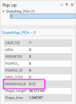

  • We have a polygon feature class named ShakeMap_PGA that is a map of severity for a particular earthquake. (Data links provided at the end.)
  • The attribute table has a Double field named PARAMVALUE that contains small decimal values for the severity. Unlike the Richter scale, these values are meaningless to most people, so we want to provide some context.
  • We have a set of threshold values to define categories (intervals) of severity based on the PARAMVALUE field.
  • We want to create a text field named severity_description that contains a succinct description of the earthquake’s intensity category for that polygon.
  • There are a few different ways to measure severity, but they all start with a numeric input and a set of thresholds to define intervals. We should make our code block function generic to work with all these cases.
That’s really all you need to know. Feel free to skip ahead to the next section, but if you want to nerd out a bit more, keep reading.

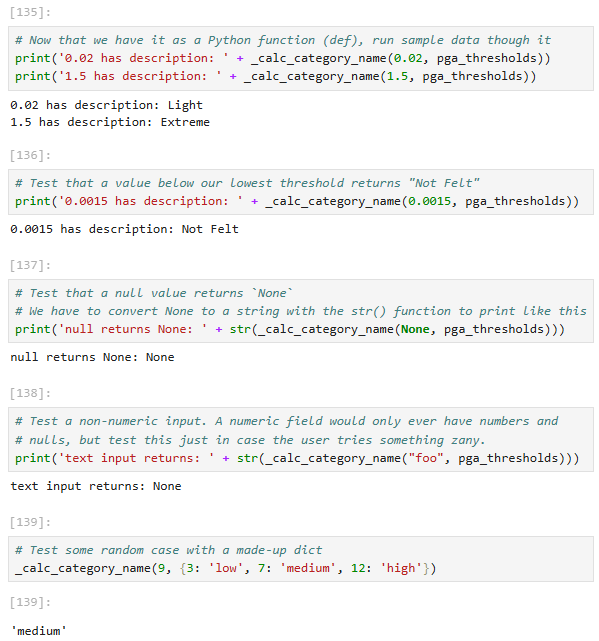

Basic Testing
Now that we have an input dictionary and a function, we can use our ArcGIS Notebook to run some tests on it. We can call it in a Notebook cell like this:
Let’s clean that up using the print function and run a few more tests:
For very simple code blocks and data sets, this testing is good enough. Once you’re satisfied, copy/paste the function’s source into the Geoprocessing tool’s code block text box in Pro. You can also run it in Python with arcpy. You should spot check your results in the attribute table and this might be all you need. For complex use cases (long functions or complicated data sets), you will want more robust testing, troubleshooting, and validation. I promised you we were going down the rabbit hole on this, so keep reading if that sounds interesting to you.
This case is in the attached ArcGIS Notebook and also script #1.

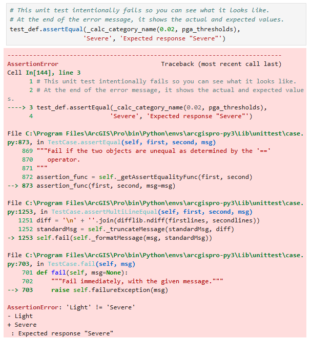

This next example demonstrates what a failed test looks like as it raises an AssertionError. In this example, we pass in the same value as before. It still returns Light, but this test expects a response of Severe, causing the test to fail.
Note how the actual value, the expected value, and the error message are on the last lines of the output.
These examples are a greatly simplified shortcut to how unit tests would normally be run. Check out the link above if you want to learn more. These unit test examples are in the attached ArcGIS Notebook.

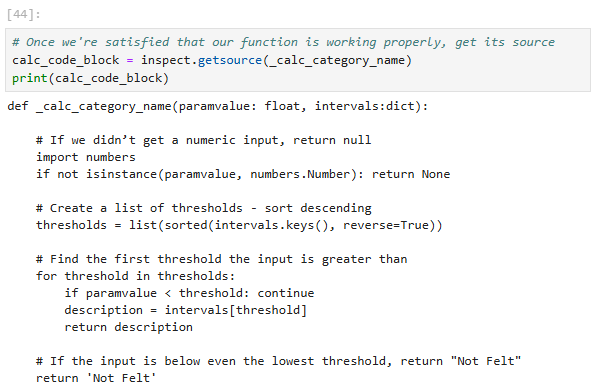

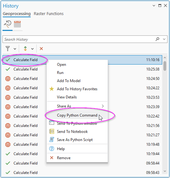

Our code block function above is named _calc_category_name. We could copy/paste the whole function into a Python string variable or the Geoprocessing interface in Pro. Every time we tweak the function, however, we have to repeat this, which is a hassle and error-prone. Instead, let’s just work directly with the function we already created. The inspect module can retrieve the source code of a function as a string:
Next, we need an expression that calls our code block function:

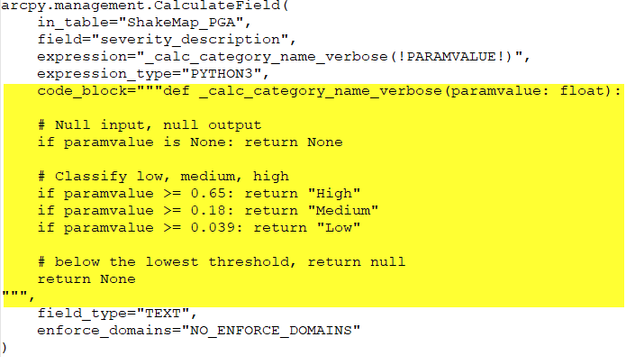

At last, we are ready to run the Field Calculator! Review the variables above if you need a refresher. If you’re familiar with the tool’s interface in Pro, the arguments in Python are straightforward, but review the docs here if you need help with the Python syntax.
calc_result = CalculateField(
    in_table=pga_layer_name,
    field=pga_description_field,
    expression=calc_expression,
    expression_type='PYTHON3',
    code_block=calc_code_block

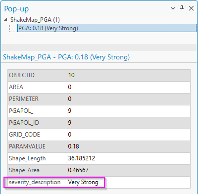

The Geoprocessing tool doesn't output any meaningful response in our Notebook. If we open the attribute table or a feature’s popup, we can see the new field with the text description populated:
This code is in the attached ArcGIS Notebook and script #2.

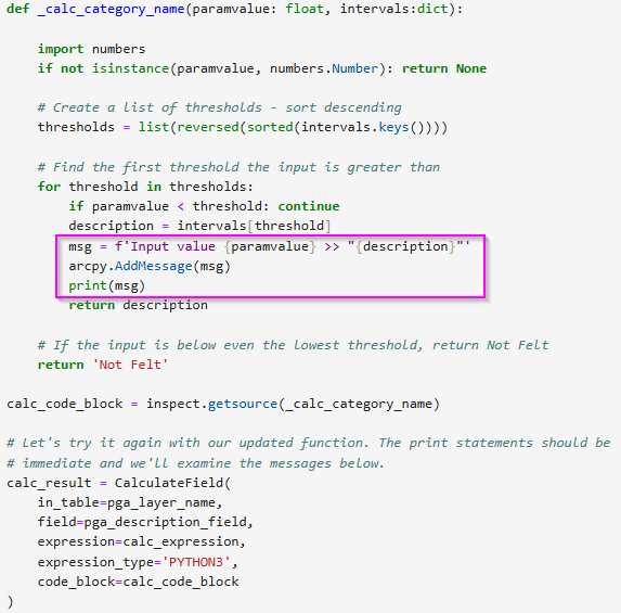

How do we troubleshoot it? The most basic troubleshooting tool of all is the print statement. The arcpy Geoprocessing framework also has a messaging queue we can write to. Let’s try both of these.
First, I tried print statements and arcpy messages in a code block in Pro’s interface, but neither produced any output. If you know how to do this, please leave a comment. We might be able to use Python loggers to output to a file, but this seems overly complicated for the tiny code block textbox.
In this example, we modify the previous code block function slightly. We create a string with our message, add it to the Geoprocessing messages, and also print it. Just like before, we retrieve the updated source code and run the tool.
Here is the output from this cell in our ArcGIS Pro Notebook:

Success! When doing this, be aware that:
  • The code block has 3 return statements, but this example only prints output for one. You can try adding it elsewhere.
  • If the function fails before it prints anything out, we may not get the desired output. In chasing a bug, we might add another print statement earlier in the code. This can lead to adding too many print statements, which can clutter up the code and create too much output.
  • Once we zero in on a condition that triggers the error, it might be better to wrap the code to print inside an if statement, so it only prints under the conditions causing the error.
  • Use caution when running this against a very large table. Similar to the previous bullet, we may want to implement a counter to only print the first 20 records or something like that.

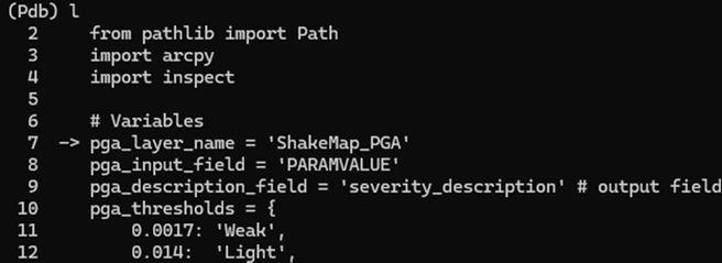

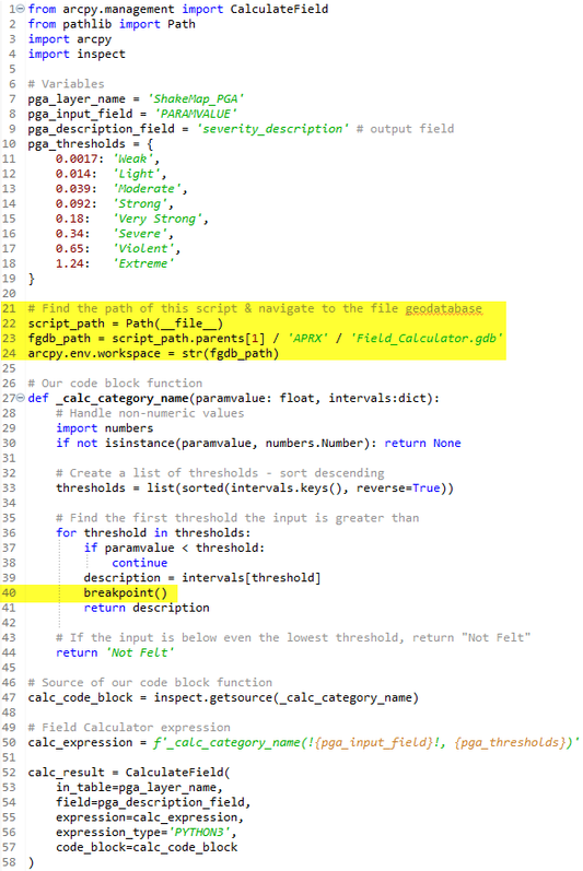

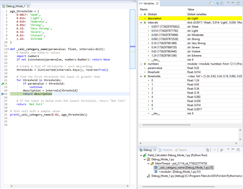

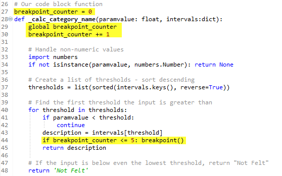

Debugging With Breakpoints

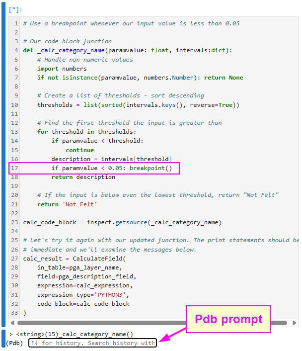

So far, we’ve tested the code block against a wide range of input values and added print statements to diagnose errors. But we still haven’t gone all the way down the rabbit hole of debugging it. For that, we will use a tool called a breakpoint that pauses the code to let us inspect it.
What Are Breakpoints?
One of the most powerful tools in troubleshooting Python code (or any language) is the ability to set a breakpoint at a given line of code. This pauses the code execution before it executes that line. While paused, we can do the following:

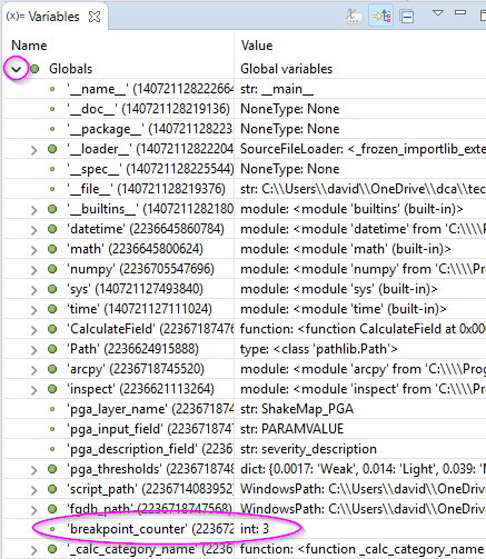

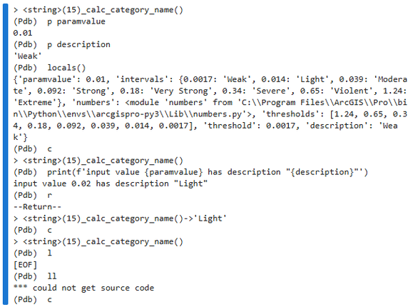

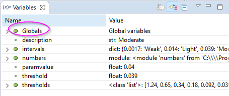

  • Inspect the variables at the local or global scope to discover their type and values.
  • Execute commands: After pausing at a breakpoint, we have a Python command line with everything from our program available to us.
    • For example, we can run functions or change the value of variables. This lets us experiment with what would happen if one or more variables had a different value.
  • View our current stack: The stack is the series of scripts, packages, and functions that have been nested to get to the current point in our code. We might start out with a .py script, call something in arcpy, which in turn utilizes another Python library, which might call something else. All of those go on our stack. When our code is failing, this is a key way to see how we got there.

Just like we added print statements to the code block function, we can add breakpoints. In the screenshot below, I am using the Eclipse Integrated Development Environment (IDE) with the PyDev plugin. This is just a bare-bones Python script where I have set breakpoints on lines 22 and 25. Because these are inside a for loop, it will stop each time it reaches these lines in the loop.
There’s a lot going on here, so let’s break down the screenshot above:
  • Line 25 is highlighted in green. This indicates that the code running in debug mode and currently paused on this line.
  • In the variables pane on the right, you can see all the variables currently in use and their values. Lists, dicts, or any hierarchical variables can be expanded. Any value that changed since the last breakpoint is highlighted in yellow (only one in this example).
  • The Debug pane on the lower right shows the stack of everything that’s running. With just one function in this script, this is pretty simple, but this can be really complex in other cases.
In the toolbar, there are buttons to resume running, terminate, and step through the code in the various ways discussed above.
This function is simple enough that running it in debug mode might be overkill. As our code grows more complex, however, breakpoints are a key tool for development and troubleshooting.
That said, when developing in an IDE like Eclipse (or VS Code, PyCharm, etc.), setting the breakpoints is just done visually in the editor (e.g.: the green dots in the margin of lines 22 & 25). Recall that what we pass the to the Field Calculator is not the function itself, but rather a text string of the function’s source code. In other words, when we use inspect.getsource() on our function and pass that string to the Field Calculator, Python won’t respect the breakpoints. In the next section, we will discuss how to set breakpoints in a way that is embedded in our code block function’s source code, so it is portable to the Field Calculator.
Using Breakpoints in the Field Calculator
To make the Field Calculator respect our breakpoints, we need to add them to our code, rather than just using the interface of our IDE to set them. To move this from ArcGIS Pro to my Python IDE, I had to make a few changes to the ArcGIS Pro Notebook we've been working with. Here is the script we will work with, below. It is attached as script #3. In particular:
  • Additional imports at the top
  • Lines 21-24: A new way to set the workspace environment variable using the currently running script’s path.
  • Line 40: Add a breakpoint() call, the equivalent of setting a breakpoint in my IDE.
That’s it! When we run the script, we can now see all the variables set within our code block as it executes. Note that the Field Calculator calls this code block function for every row in our table which pauses on the breakpoint each time. The screenshot below shows the debugging information, noting that this is just for one sample row. The IDE highlights the 3 variables that changed since the breakpoint on the previous loop.
I don’t often use this, but there is also a Python command prompt where we can execute commands while we’re paused for a breakpoint. One thing we may want to try is updating variables. In this case, I modify a description right before it is returned from my code block.
If I check in Pro, here is that feature:
Note that there are 3 return statements in my code block, but only one has a breakpoint. This is good enough for this demo, but we could insert additional breakpoints, as needed.
Debugging – Too Much of a Good Thing
In this example, we have a breakpoint in our code block function. The code will pause for every record. This feature class only has 20 records, but what if it had 20,000? If we’re only having trouble with certain input values, for example, we could have an if statement to test for that condition and put our breakpoint inside that. This would enable us to focus our debugging on the problem cases.
In this next version of the script, we’ll implement a counter. Let’s only stop for breakpoints 5 times. The challenge is that each time the code block function runs, it starts fresh with no carry-over from the values from the previous record. So how can we implement a counter if each code block function call has no history of the previous loops? This is where we use global variables to enable interaction between a variable created in our main script and the code running in the code block function. Just zooming in on the parts that changed, here is how we’d do that (see script #4 for the full code):
When it stops, debug mode shows us all the same things as before, but where’s our counter? Debug mode shows us the local variables, but recall that this is a global variable, as signified by the global syntax.
If I expand the global variables, there it is.
In this example, we create a global variable before calling the Field Calculator and then our code block function updates it each time it is called. Our code block function could use this approach to pass back any kind of data to our main script as we loop through the table.
Debugging Without an IDE
I highly recommend doing your debugging in an IDE. But what if I don’t have a fancy IDE? Our workflow might be in an ArcGIS Notebook and it’s just too much work to move our code to an IDE just for debugging. We might also be in an environment that only gives us a command prompt (terminal) and no admin rights to install software.
Here is how to approach debugging at the Python command prompt. With ArcGIS Pro, there is an app installed called “Python Command Prompt”. Let’s open that, change directories to where the script is, and run it. Python will stop at the breakpoint and give us the Pdb (Python debugger) command prompt:
This acts just like running Python at the command prompt, except we are stopped in the middle of our script with all the variables set. We can execute lines of Python code, for example:
This lacks the intuitive variables pane from the IDE, but you can show all the variables in your local scope and issue regular Python commands with them:
(Pdb) locals()
{'paramvalue': 0.01, 'intervals': {0.0017: 'Weak', 0.014: 'Light', 0.039: 'Moderate', 0.092: 'Strong', 0.18: 'Very Strong', 0.34: 'Severe', 0.65: 'Violent', 1.24: 'Extreme'}, 'numbers': <module 'numbers' from 'C:\\Program Files\\ArcGIS\\Pro\\bin\\Python\\envs\\arcgispro-py3\\Lib\\numbers.py'>, 'thresholds': [1.24, 0.65, 0.34, 0.18, 0.092, 0.039, 0.014, 0.0017], 'threshold': 0.0017, 'description': 'Test value set from Pdb with input 0.01'}
(Pdb) type(thresholds)
<class 'list'>
You can also access the global variables in this way. It starts with a bunch of internal variables, but later on it gets to the good stuff:
(Pdb) globals()
{'__name__': '__main__', '__doc__': None, [...SNIP...], 'pga_layer_name': 'ShakeMap_PGA', 'pga_input_field': 'PARAMVALUE', 'pga_description_field': 'severity_description', 'pga_thresholds': {0.0017: 'Weak', 0.014: 'Light', 0.039: 'Moderate', 0.092: 'Strong', 0.18: 'Very Strong', 0.34: 'Severe', 0.65: 'Violent', 1.24: 'Extreme'}, 'breakpoint_counter': 1, '_calc_category_name': <function _calc_category_name at 0x00000147D792E160>, 'calc_code_block': 'def _calc_category_name(paramvalue: float, intervals:dict): [...SNIP...]
Those are just regular Python commands that you can run whether you’re debugging or not. Now, let’s look at some commands specific to the Pdb prompt:
(Pdb) a   # show the input arguments to the current function
paramvalue = 0.01
intervals = {0.0017: 'Weak', 0.014: 'Light', 0.039: 'Moderate', 0.092: 'Strong', 0.18: 'Very Strong', 0.34: 'Severe', 0.65: 'Violent', 1.24: 'Extreme'}
(Pdb) w   # show the stack
script4_global.py(56)<module>()
-> calc_result = CalculateField(
  c:\program files\arcgis\pro\resources\arcpy\arcpy\management.py(8504)CalculateField()
-> gp.CalculateField_management(
  c:\program files\arcgis\pro\resources\arcpy\arcpy\geoprocessing\_base.py(533)<lambda>()
-> return lambda *args: val(*gp_fixargs(args, True))
  <expression>(1)<module>()
> <string>(18)_calc_category_name()
(Pdb) p description  # print [the print() function also works]
'Weak'
Next, let’s examine a few commands we can run to control our code execution in Pdb. The one I use most is c to continue, which will run until the end of the script or the next breakpoint:
(arcgispro-py3) > python script4_global.py
(Pdb) p f"{breakpoint_counter}: {paramvalue} >> {description}"
'1: 0.01 >> Weak'
(Pdb) c
'2: 0.02 >> Light'
(Pdb) c
'3: 0.04 >> Moderate'
(Pdb) c
(Pdb) c
(Pdb) c
Done

Debug Mode in ArcGIS Pro Notebooks
Notebooks (running in Pro, Jupyter, Enterprise, or ArcGIS Online) are inherently great for debugging. We can create a cell with a few lines of code, run it, and then poke and prod at the values in the next cell. That’s exactly what we did above in our very first tests. You might be wondering if we even need debug mode when notebooks will pause whenever a cell finishes executing. Running a cell in a notebook and pausing to inspect the results is missing two key capabilities that are relevant to the Field Calculator:
  • Pausing to debug within a loop is one of the most common use cases. If a notebook cell has code that loops, the notebook will run that loop to completion before pausing. The Field Calculator loops through the records in our table, but notebook cells don’t have a way to pause on each one.
  • We can make notebooks pause our code anywhere we want by putting as few lines of code in a cell as it takes to isolate a problem. But what if our code calls external functions, such as the Field Calculator? A notebook will execute all the external code called by our cell before pausing, whereas debug mode gives us the ability to step into that code.
Fortunately, ArcGIS Notebooks do support debug mode. In this example, we add a breakpoint when the input value is less than 0.05 (our table has 3 of these).
Once it hits the breakpoint, we get a Pdb prompt with a blinking cursor. We don’t need to rehash all the command usage covered above, but this screenshot gives you a basic idea of how it works. Here is an example of running one (recall that we have 3 records with a value below 0.05):
Notes:
  • I tried to use the global variables to create a breakpoint counter like we did previously. This produced the dreaded 999999 error from the Field Calculator running a Notebook in ArcGIS Pro. I’m not sure why it crashes when I try to use global variables.
  • The commands l and ll, don’t work here. I sometimes get this at the command prompt, too.
  • The line numbers don’t exactly align, but we can figure them out. Note where it says (15) over and over -- that’s our breakpoint’s line number. Since our function’s source starts on line 4 of the cell, let’s subtract 3 from each line to make that line 1. Our breakpoint() call is on line 17 of the cell, or subtracting 3, on line 14 of the function. My best guess is when the inspect module reads the source in, the if statement and the breakpoint() call on line 14 are considered separate lines of code, putting our breakpoint on line 15. When debugging, if you’re having trouble with line numbers, you might want to start your function at the top of a cell (on line 1) and avoid adding code on the same line as an if statement.
  • When we hit the last breakpoint, the final continue call just ended the Pdb prompt mode, the cell’s code finished executing, and the next cell in the notebook was activated.
