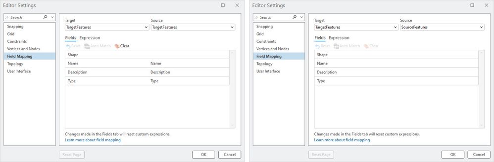

By default, there is an auto-match capability which is sufficient for some workflows.  Auto-matching is done for all source and target field pairings, regardless of what is currently chosen in the source and target dropdowns.  Even though you can’t see the field mapping, there is field mapping for all layer combinations in the map that will be used by the tools.
Auto-Matching results.  On left, all fields are matched.  On right, no fields are matched.Auto-Matching results.  On left, all fields are matched.  On right, no fields are matched.

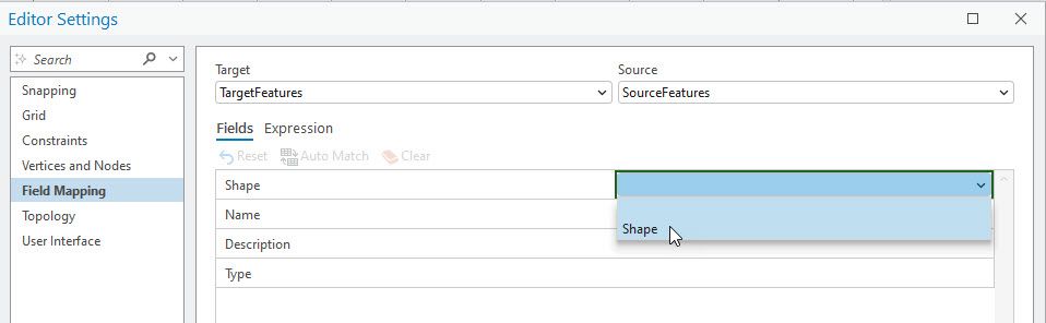

1. Transferring geometry
Map shape fields from source to target.
To transfer geometries, match the Shape fieldTo transfer geometries, match the Shape field

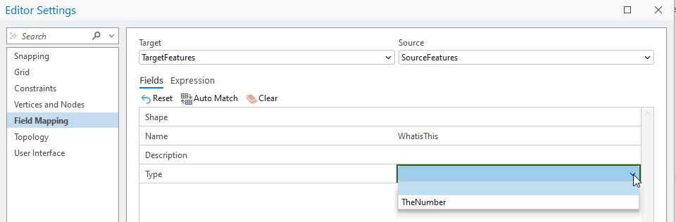

2. Field names vary and do not auto-match
Choose source and target from the dropdowns, for each target field on the left, choose the source field from the dropdown on the right.  The dropdown only shows fields of the same data type.
Matching fields when the field names do not auto-match.Matching fields when the field names do not auto-match.

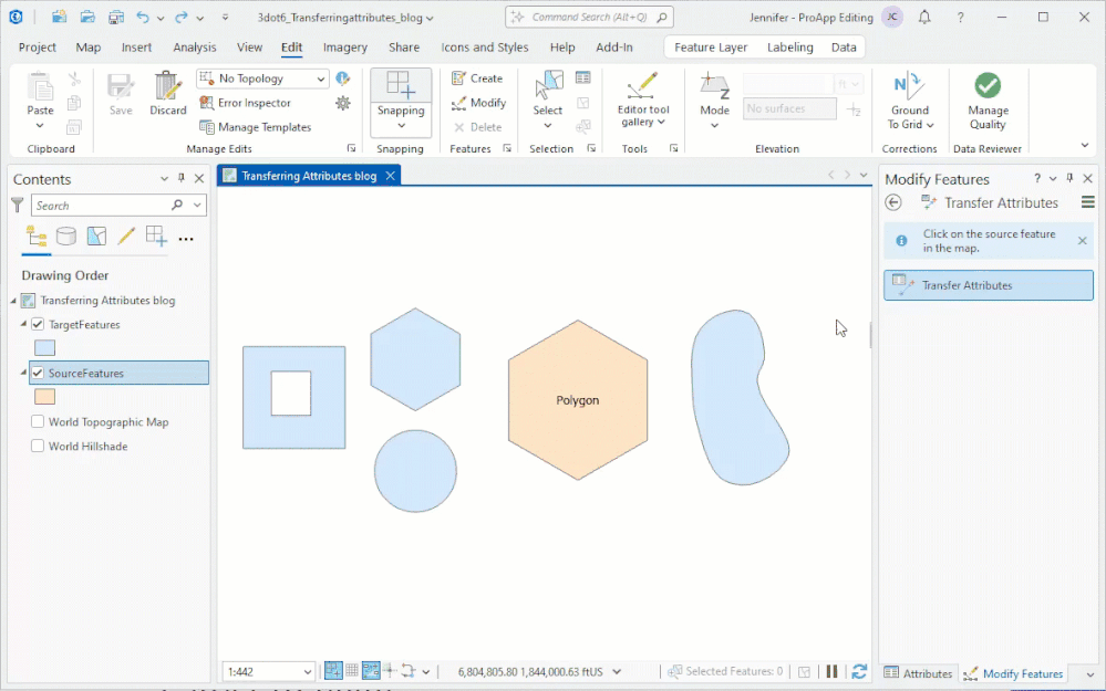

Transfer Attributes is a tool to interactively transfer attributes in the map from a source feature to one or more target features.  The tool does not use selection sets, rather, it uses clicked locations to find features to work with.  The target feature must be selectable, editable and visible, whereas the source feature must be selectable and visible, it does not need to be editable.
In its simplest use, transferring from one feature to another, follow these steps
  1. Verify Field Mapping configuration for source layers and target layers. If transferring geometry, remember to map the Shape field.
  2. From the Modify Features pane, activate the Transfer Attributes tool
  3. In the map, click the source feature.  The cursor will update to show the source feature’s Display Expression.  In the map, click the target feature.  Attributes are transferred from the source to the target and the tool is reset
  4. Repeat steps 2 and 3, as needed, to transfer attributes between features.
To transfer from one source feature to multiple target features, after clicking the source feature, hold down the Shift key until all target features have been clicked.  Attributes are transferred with each click.  Once the Shift key is released, the tool is reset and can be used again.
Transfer Attributes to one feature and then multiple features.Transfer Attributes to one feature and then multiple features.

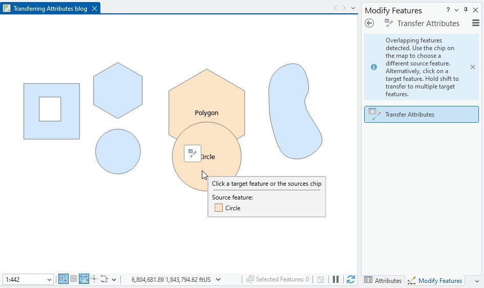

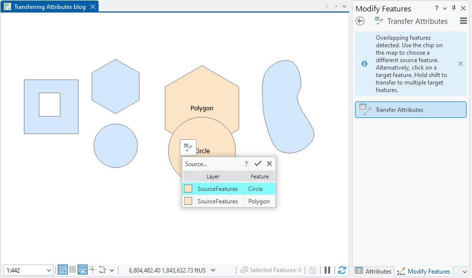

Just like in the basic scenario, activate the tool and click the source feature.  If there are overlapping features, you will see the chip in a collapsed state.  Interacting with the chip is optional; if you do not expand the chip and choose a feature, the tool will default to the topmost feature.  To choose a different feature, click the chip to expand and show the grid, highlight the row of the feature you want and click the checkmark (or double click the row).  You will also notice the cursor greeting showing the feature identifier of the source feature.
Overlapping sources with chip collapsed.  Also note the notification banner in the tool's pane.Overlapping sources with chip collapsed. Also note the notification banner in the tool's pane.
Overlapping sources with chip expanded.Overlapping sources with chip expanded.
