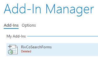

Click the Add-In Manager menu item on the left hand side of the Project Setting page
Click on the RivCoSearchForms Add-In in the list of My Add-Ins
You can verify the version is out of date by reviewing the Date and Version information prior to removing the Add-In
Click on the Delete this Add-In button at the bottom right-hand corner of the screen
The Add-In will still appear in the list of My Add-Ins until you close ArcGIS Pro, but it will say it is Deleted:

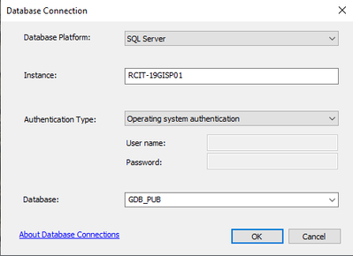

The search tool will verify that your current active map has the layers the tool requires.  If necessary it will add them to the map provided that the tool is able to create a Database Connection to the SQL Server Database Platform using the RCIT-19GISP01 Instance with Operating System authentication using the GDB_PUB Database.

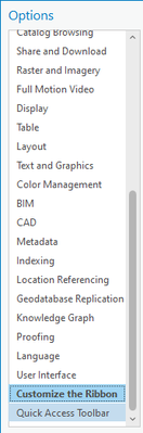

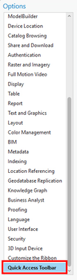

In the Options dialog scroll to the bottom of the list on the left side of the dialog and press the Quick Access Toolbar option.

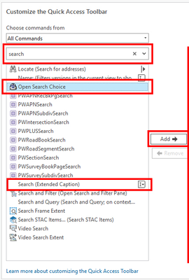

In the Customize the Ribbon combobox in the Options dialog choose All Commands
Type search into the textbox dropdown and choose the Open Search Choice button and press the Add button and then choose the Search (Extended Caption) combobox and press the Add button.  The icon for the Open Search Choice button has changed from a Cat to R2D2.
The list of tools should look like the items shown below and press the OK button

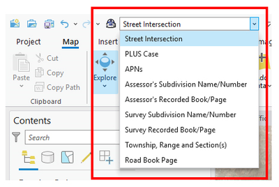

The Quick Access Toolbar should now look like this.

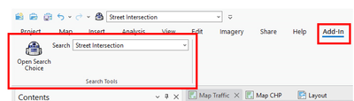

You can also access the Search Tools through the Add-in tab:
Choose the search you want in the dropdown and press the R2D2 button to launch the search dialog.
