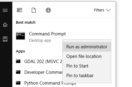

  3. Cloning creates a copy with all it's dependencies in a less than obvious place and it is here you need to install d-tale. So having cloned the environment fire up the Windows command line and make sure you open it in Administrator mode:
