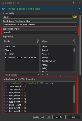

  2. Add a new field to the feature class containing attachments. Name this field "Attachment Count With Format" and set its type to Text.
     Open the attribute table, right-click on the newly added field "Attachment Count With Format", and         select "Calculate Field".
  4. Change the expression type to Arcade and copy and paste the following code. You can add more             formats as needed:
var attachments = Attachments($feature);
