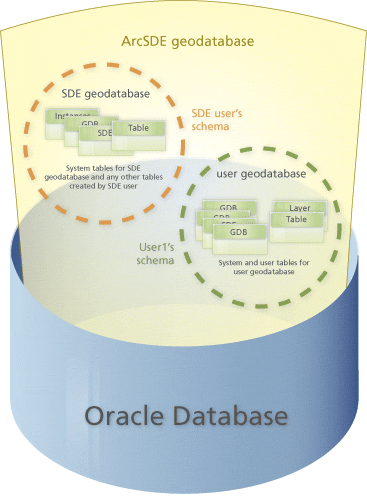

1. INTRODUCTION
ArcSDE User-Schema Geodatabases in Oracle are deprecated.
MarceloMarques_1-1720461608715.png________________________________________________________________________________________________

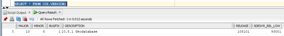

2. DEPRECATION PLANS
What are the deprecation plans for ArcGIS products?
MarceloMarques_2-1720458030864.png________________________________________________________________________________________________
IMPORTANT:  If you are using ArcGIS Pro 3.x and trying to edit data and use geodatabase features like Traditional Versioning and or Branch Versioning with an ArcSDE User-Schema Geodatabase in Oracle, then this is not a recommended nor a supported workflow with ArcGIS Pro.

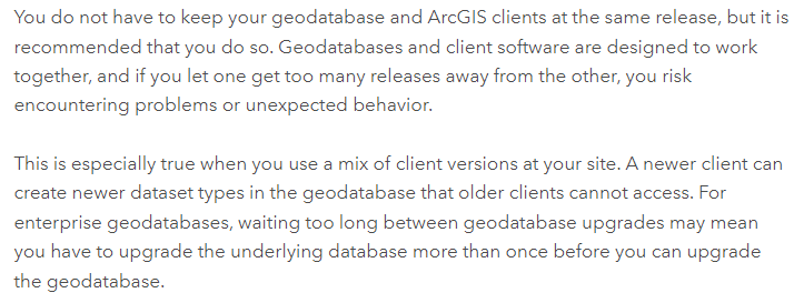

3. GEODATABASE COMPATIBILITY
ArcGIS Pro and Geodatabase compatibility
