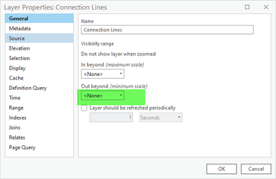

If it's what @JeffWard mentioned, you could also try to turn off the scale dependency on the connection lines layer, by setting the "Out beyond" to <None>:

I checked and there is no definition query on the connection lines layer. I turned off the scale dependency and restarted Pro as you suggested and I'm still getting the same issue.
