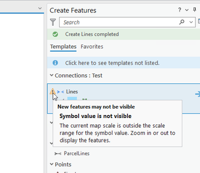

One question - can you create connection lines using the Create pane and a feature template - and do you see this warning? This may be causing your issue...
