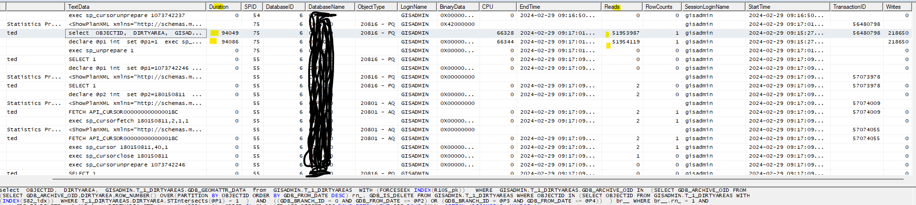

we did some test using SQL Server Trace and found out that dirty area takes a lot.

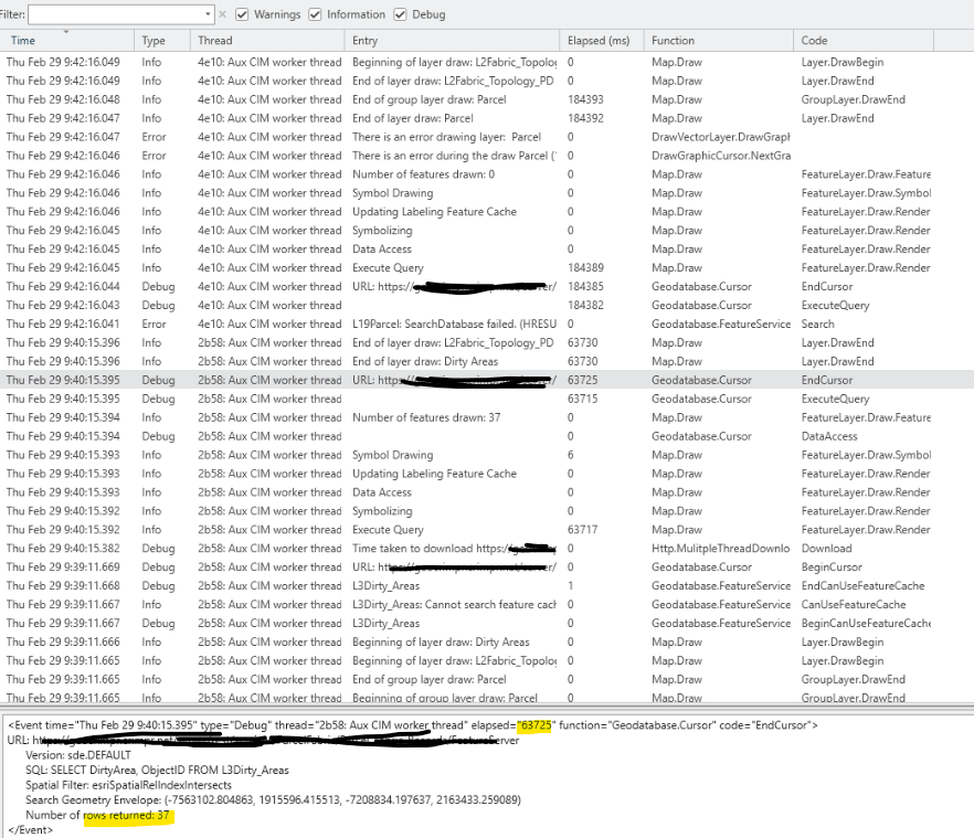

And when we used ArcGIS Pro diagnostic Monitor, we found a same behavior but, it only returns 37 rows, and other, 0 rows.
We did this diagnostic also when we have validated all dirty area and the time to load the layers was the same.
So my question is, why Dirty area layer has so bad performance, what could be the reason for this behavior.
