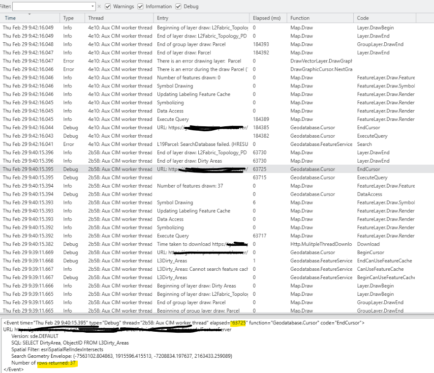

Hello,
We are using parcel fabric 11.1 with  ArcGIS Pro 3.1.4 and Database SQL Server Standard 2019 We have a parcel fabric with 1.5 millions parcels. When we use Parcel Fabric and do not turn on dirty area, Parcel Fabric behaves Ok, with over 13 people editing at the same time.
if no body is connected and editing on parcel fabric, display dirty area takes almost 1.5 minutes but when all are connected, it takes almost 3 minutes to display.

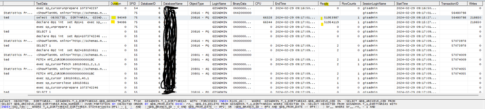

we did some test using SQL Server Trace and found out that dirty area takes a lot.
And when we used ArcGIS Pro diagnostic Monitor, we found a same behavior but, it only returns 37 rows, and other, 0 rows.
We did this diagnostic also when we have validated all dirty area and the time to load the layers was the same.
So my question is, why Dirty area layer has so bad performance, what could be the reason for this behavior.

RobertKrisher
How many rows are returned when you run the GetCount geoprocessing tool (or when you open the attribute table)? This is how many dirty areas are 'active' in your version.
How many rows are in the dirty areas table if you do a count statement directly against the table using SQL? This is the total number of active and historical records in your geodatabase.

RobertKrisher
Statistics, indices, and the spatial index are the most common cause of performance issues with drawing that layer. Its also recommended to not draw that layer at small scales (when zoomed out) because of the limited usefulness of the layer when zoomed out and the potential performance hit (even once you've tuned it properly).
If you're having problems getting the tuning right, log a case with support.
