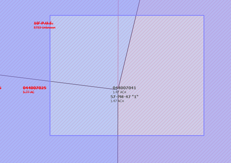

DianeBaker
Well I can provide you the vertices but I think a restart of Pro fixed it.  Next time I'll just restarting my project before querying the community 🙄  I just went back to the problem area added the vertices as requested, took my snapshot, ran Validate Topology and lo and behold no odd movement.  I'm at a loss at what could have possible changed. The scale below is1:33 scale
